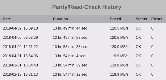

One of my servers is built using an HP Microserver Gen 8. It has two parity disks and two data disks in the built-in bays, and four more data disks connected via eSATA. Additionally, I have a two SSD cache pool and a Blu-ray drive inside the main case. The external disks are housed in an ICYCube. The Blu-ray drive is connected to the built-in optical drive port. I chose an expansion card that supports eSATA at 6 Gb/s because I knew that link would be a bottleneck. There are several variations on this card and I chose the one with two internal SATA ports (for the SSDs) and two eSATA ports (I'm just using one for the ICYCube) and the x2 PCIe interface. It uses a Marvell 88SE9235 controller but I've had absolutely no problems with compatibility with unRAID. I attribute that to the fact that it uses the standard AHCI driver:
07:00.0 SATA controller [0106]: Marvell Technology Group Ltd. 88SE9235 PCIe 2.0 x2 4-port SATA 6 Gb/s Controller [1b4b:9235] (rev 11)
	Subsystem: Marvell Technology Group Ltd. 88SE9235 PCIe 2.0 x2 4-port SATA 6 Gb/s Controller [1b4b:9235]
	Kernel driver in use: ahci
	Kernel modules: ahci
I mentioned a potential bottleneck and that is due to the fact that the ICYCube uses a single eSATA connection and a port multiplier but the truth is that in normal use only one of the disks is being accessed at any particular time. The worst case scenario is during a parity check or rebuild,  when all four disks are being accessed simultaneously. However, even that is not as bad as might be feared. I'm more than happy with the speeds I'm getting with all 6 TB disks:
The ICYCube works well, has an internal power supply and a quiet fan and SMART data and temperature readings are passed through the port multiplier without problems. The only slight downside is that it cost me more for the ICYCube than for the Microserver but I don't blame ICYDock for that - their price is fair, it's just that the Microserver was ridiculously cheap. One thing I would not do is move parity disks outside the main case. The eSATA cable is annoyingly non-flexible and a little too long and the connectors aren't locking but by keeping the server away from children and pets it has actually turned out to be more mechanically reliable than either of my conventional (as in, all in one case) servers where I've been fighting against unreliable SATA cables - I no longer use the traditional stiff, flat, red ones. I've replaced them all with these. They are much more flexible, they have a figure of eight profile, the latches work reliably - and they're blue!
