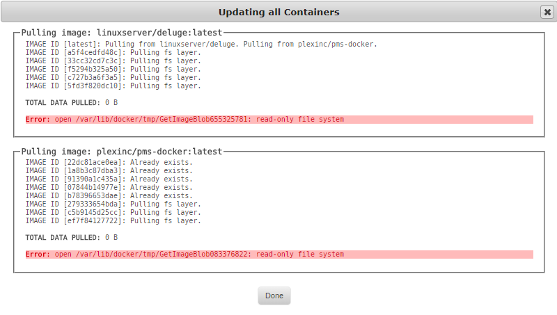

I get server error when i try to remove a docker. Tried to update all and get this error:
5 hours ago, johnnie.black said:
Your docker image is corrupt, delete and re-create.
@squid Not sure if you missed what i first wrote, otherwise please elaborate as to how i should delete the docker image
Settings - Docker.  Stop The Service
Advanced View, Delete the image
Re-enable the service
Apps Tab, Previous Apps, check off all your apps you want installed again.  Hit "Install Multi"
