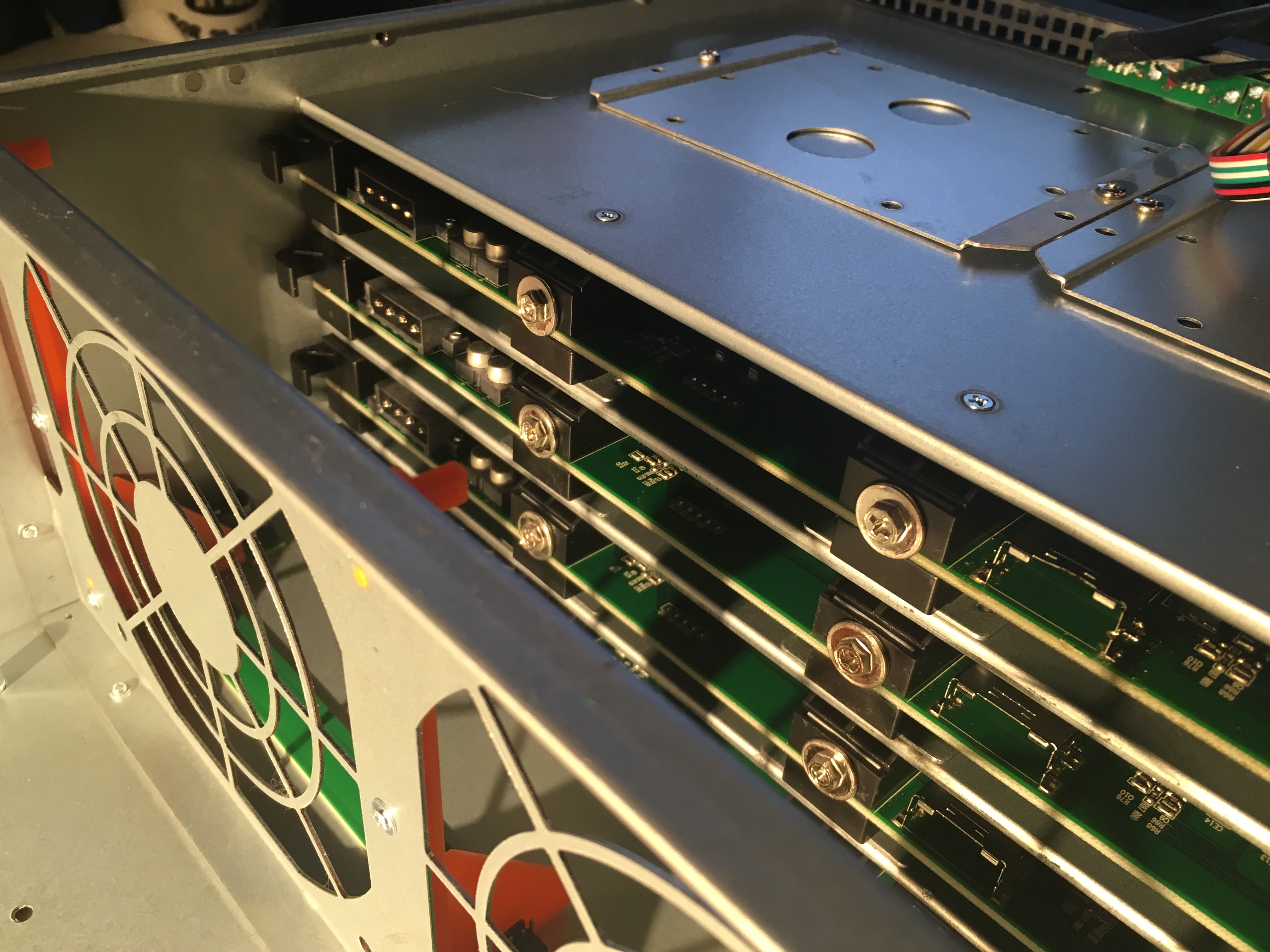

April 23, 20188 yr Author That's what I expected as well. Instead there's a clear 'keep the protective socket caps (in case of RMA)' message and the fact that the motherboard can indeed run using just one CPU. But no specific instruction on what to do with the unused socket - so thanks for the response @jonathanm Other news - the chassis from Server Case turned up today. Really impressive looking thing in the flesh.....I just have to figure out how to connect the hot-swap drives up to the rest of the server. Looks like one bank of 4 drives has 4-pin Molex power connections and the next block of 4 has what (at first glance) appear to be SATA connections. But, unless I'm blind, there's no other connections....let me take a good look at this thing...... edit: a picture is worth a thousand words so they say.... Edit 2: It looks like this is a SAS - SATA connection thing (never encountered it before). Looks like these cables will fit: https://www.newegg.com/global/uk/Product/Product.aspx?Item=N82E16812117624&cm_re=mini_sas_to_sata-_-12-117-624-_-Product Question - are SAS <> SATA cables into the motherboard likely to cause me a headache or three? Edited April 23, 20188 yr by MrLeek
April 23, 20188 yr Author 99% certain that I need a REVERSE SATA/SAS breakout cable (since i'm going from motherboard SATA ports to a SFF-0807 backplate). Wrting this partly so that i can get corrected as needed....and also to keep on track whilst I search for the right cable - the number of times I've ended up looking at the wrong type of cable because Google/Amazon is trying to 'help' me....grrr!!
April 23, 20188 yr See this post: https://lime-technology.com/forums/topic/6723-sas-to-sata-cables-forward-or-reverse-which-where-why/
April 23, 20188 yr Author cheers for the link - unless i'm going mad this is the key sentence for me: If The Motherboard/host-Controller side are SATA connectors and the backplane is a SAS connector then you must always use a SAS to SATA Reverse Breakout Cable. " That is right......right?
April 23, 20188 yr sata --> sas = reverse breakout. sas --> sata = forward breakout. ...but wait with ordering till some else also confirms. To be sure.
April 23, 20188 yr Author It would be the more expensive cable (and one that seems to be harder to get hold of!) - cheers both, much appreciated!
April 23, 20188 yr 2 minutes ago, uldise said: Yes, that's correct, if you look from MB/SAS Card side. Yes I did! Thanks for confirming.
April 23, 20188 yr Just now, uldise said: Yes, that's correct, if you look from MB/SAS Card side. Yes, it's clearer to use controller - drive terminology. single controller connection -> multiple sata drives = forward breakout multiple controller connections -> drive backplane single connection = reverse breakout
April 23, 20188 yr 3 minutes ago, MrLeek said: It would be the more expensive cable see here just for example: https://www.ebay.com/itm/Norco-Discrete-SATA-to-SFF-8087-Mini-SAS-Reverse-breakout-cable-C-SFF8087-4S-NEW/111402848253?hash=item19f0208ffd:g:W6QAAOSwFAZTu5ED
April 23, 20188 yr Author 1 minute ago, jonathanm said: Yes, it's clearer to use controller - drive terminology. single controller connection -> multiple sata drives = forward breakout multiple controller connections -> drive backplane single connection = reverse breakout Also consider which 'end' is doing the work. If the motherboard is where the controller is, then it has to be a reverse connection into the backplate
