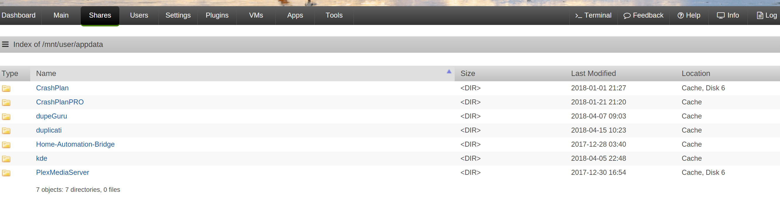

At this Step 7,  I get stuck again because after the mover finished, I can still see that appdata and system have data on Disk 6 (see screenshots). (Diagnostics attached after last "move now" push)
Is this again because I have duplicate file names?
If so, what is the best strategy to fix the situation? I only care about these dockers, so the rest can be deleted:

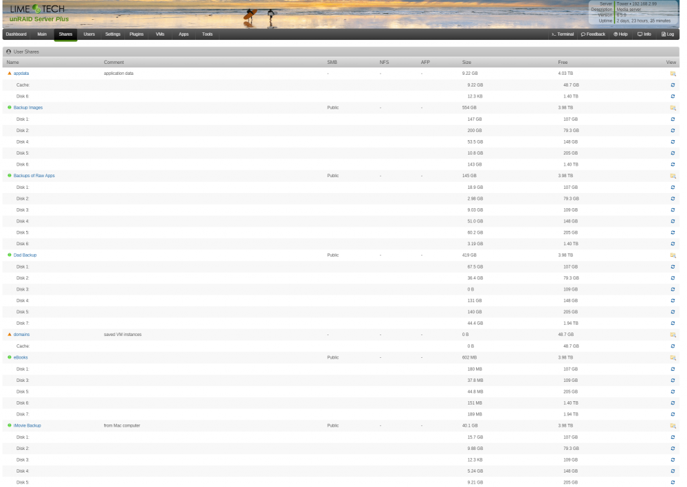

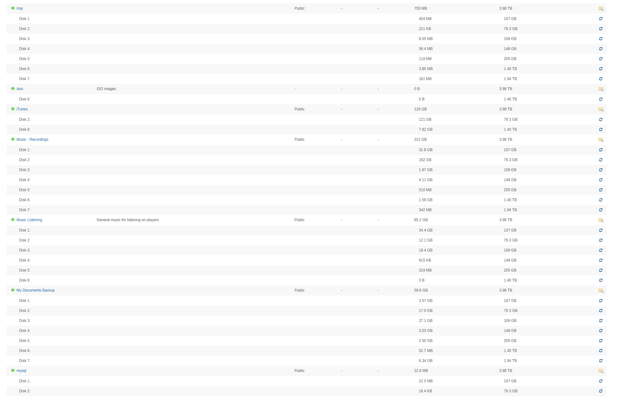

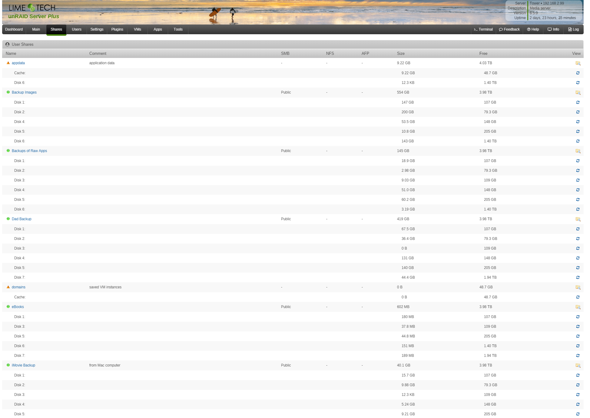

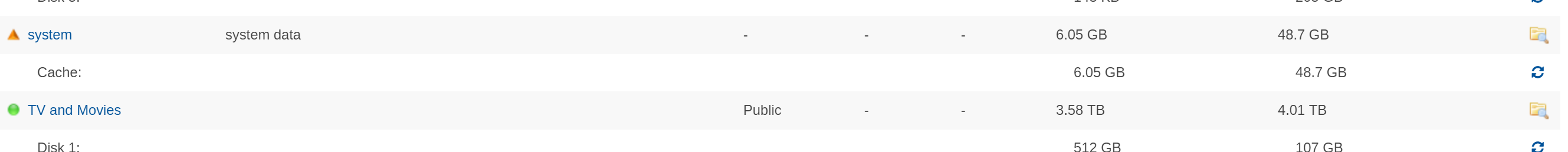

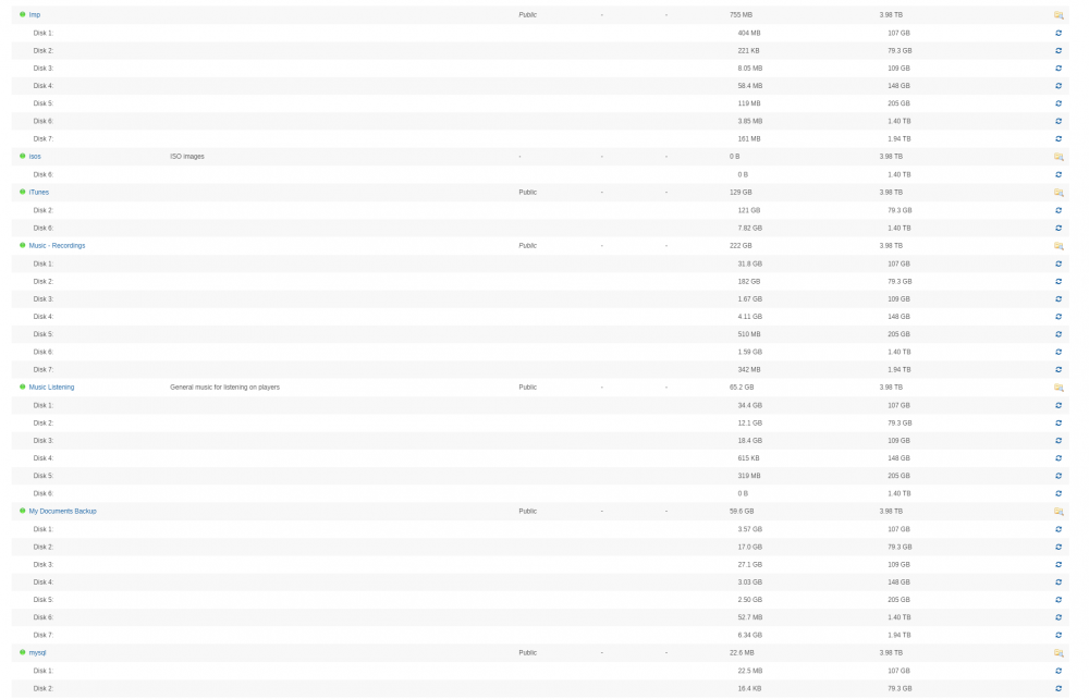

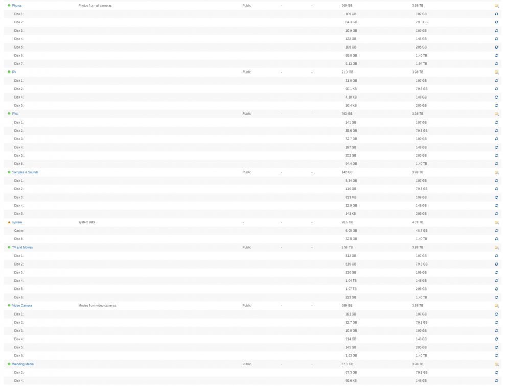

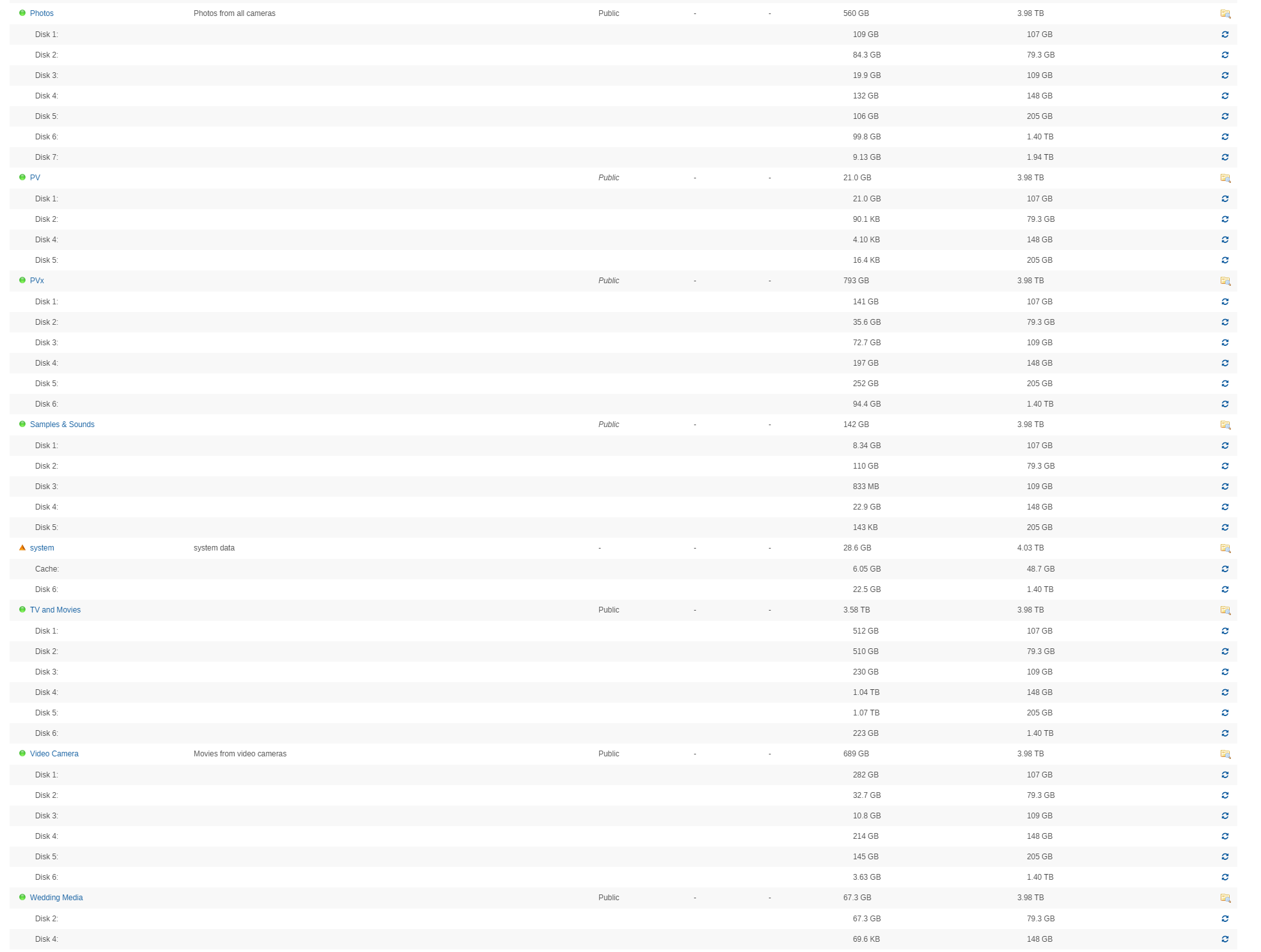

OK, so I've reached the last step of trurl's instructions:
"After all that, go to the User Shares page and click Compute All and when it's done post a screenshot. After we get your shares where they need to be we can work on the other problems."
Here are the screenshots requested of the Compute All.  Let me know what to do next. I'm mostly worried about the Duplicati (the rest I can rebuild, if needed). I have all my settings inside the Duplicati docker and never exported my configs, stupidly.
What is on disk6 in the appdata folder and in the system folder?
I don't know. I cleared out the appdata ..it was those ..DS store files.

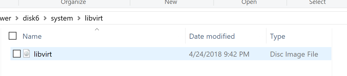

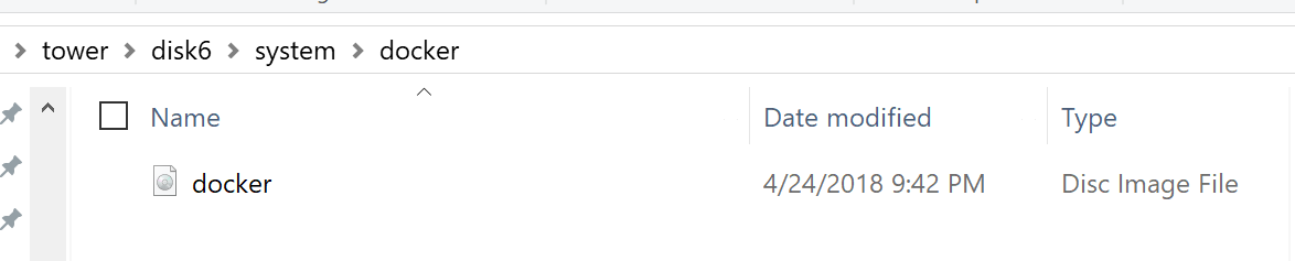

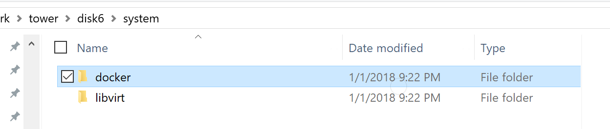

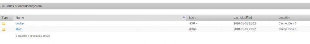

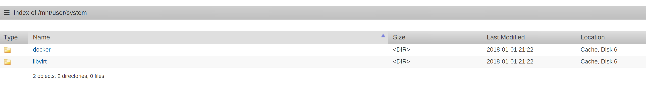

Here's the Disk 6 System data. Can I delete?
Yes delete. Your system share should be cache-prefer now so when we recreate docker image it will be on cache.

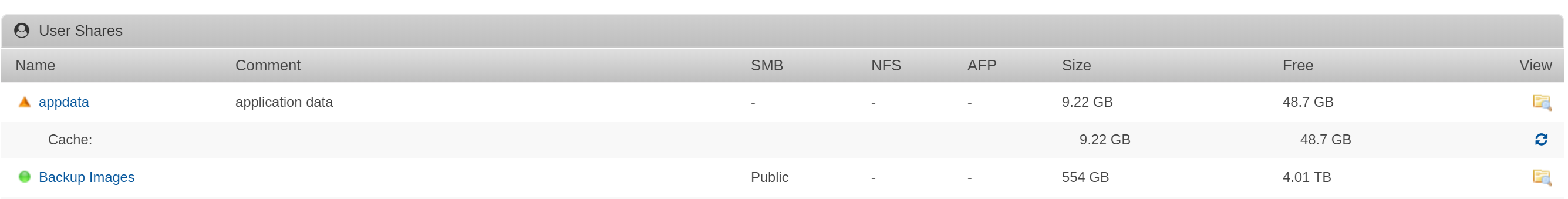

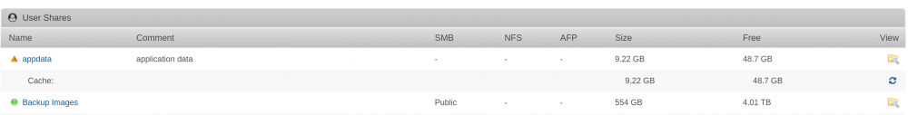

Ok, done.  Do you need to see another screenshot of the whole thing?  I've attached a screenshot of just appdata and system, showing they are just on the cache drive now.
If all of your other shares are like the previous screenshot then you should be good.

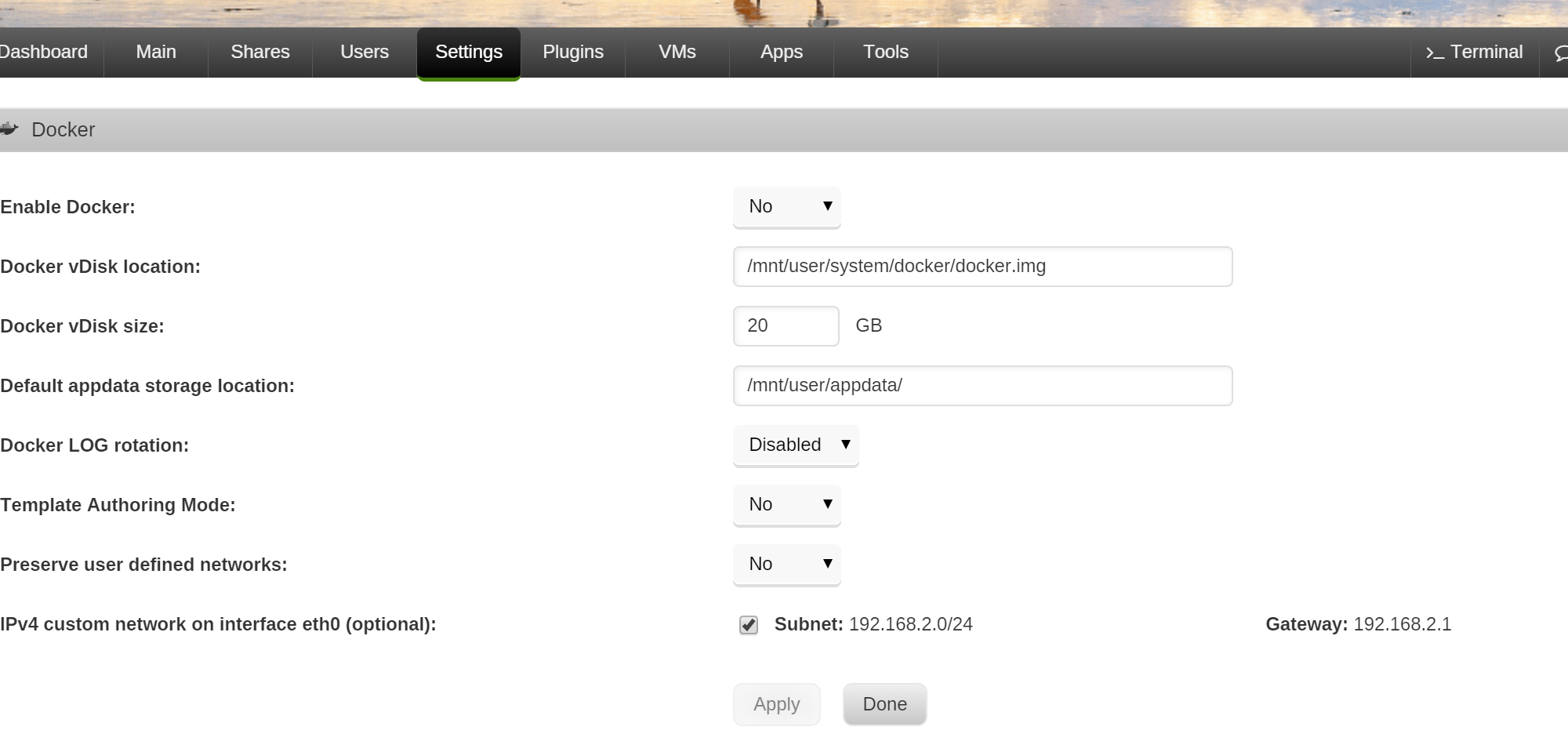

Now, in Settings - Docker, I suggest you delete docker image and create a new one. What path do you have for it?
And just to double check everything else, confirm that system, appdata, domains user shares are cache-prefer and all other user shares are cache-no.
Done. I deleted the image, and here's how it sits now.  (also doublechecked the cache settings on each share)
OK, you should be good to enable Docker. Then you can go to Community Applications - Previous Apps and it will let you reinstall any of your previous dockers with their previous settings.

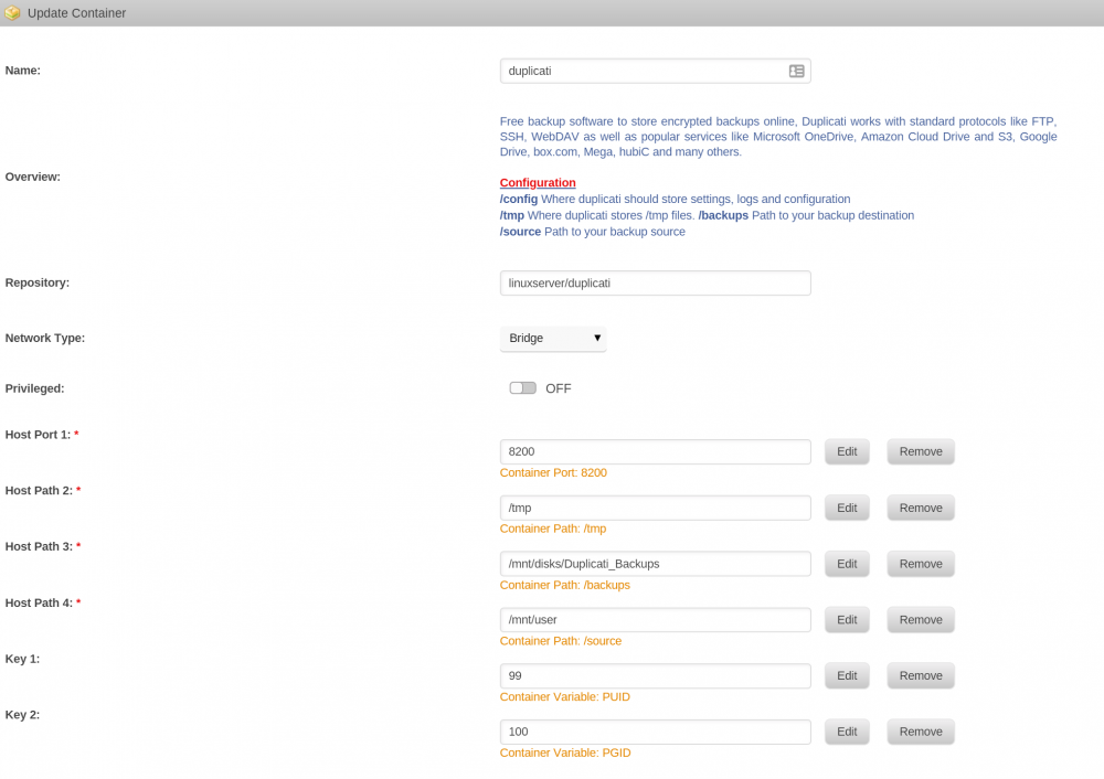

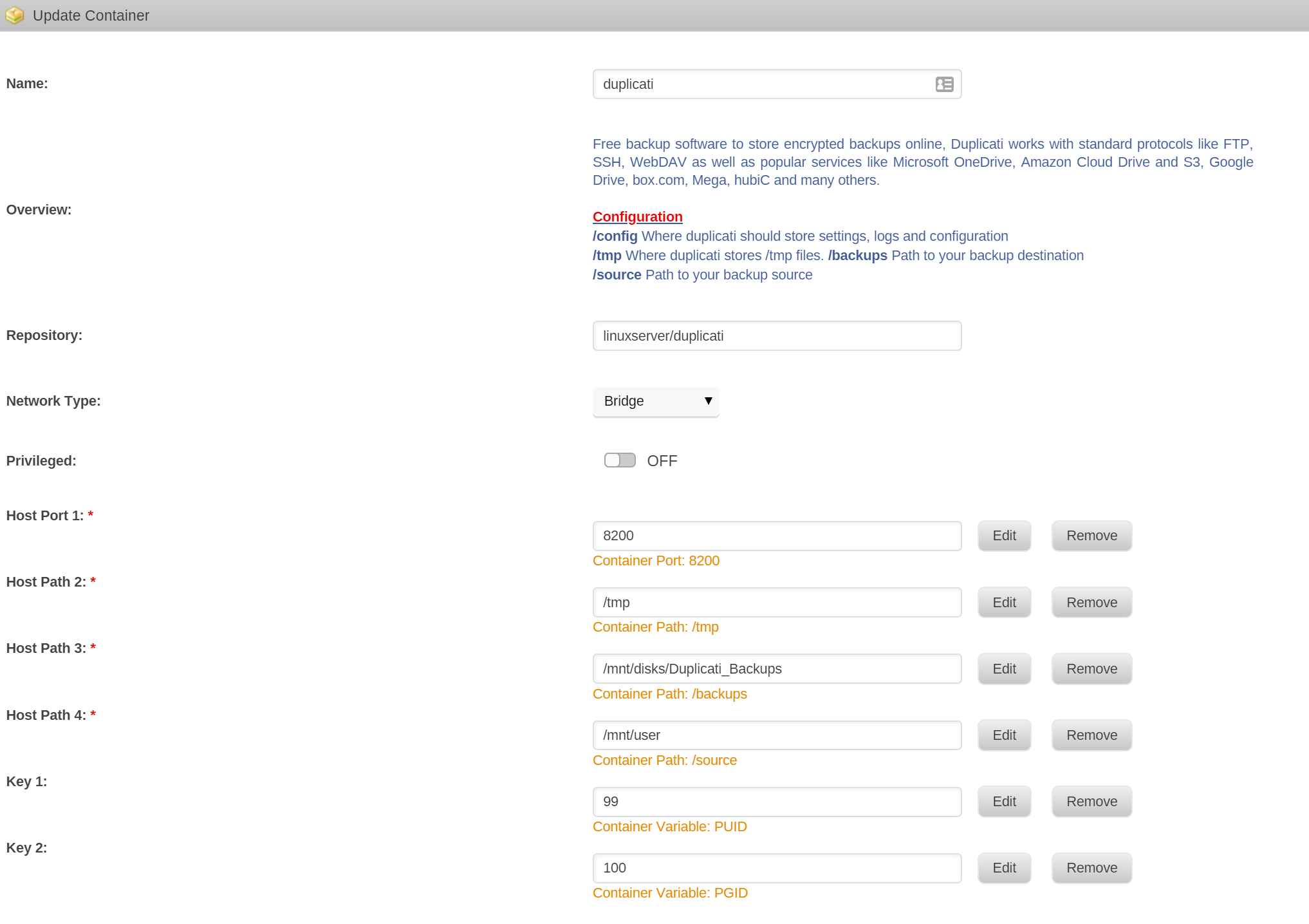

Ok, then moving on to duplicati, which is the one I'm most fearful of not being able to recover intact with all my settings & connections to onedrive (I switched when Crashplan for home user was shutdown by the company. My view was that getting Office 365 with 5 TB for a family subscription made the most economical sense).

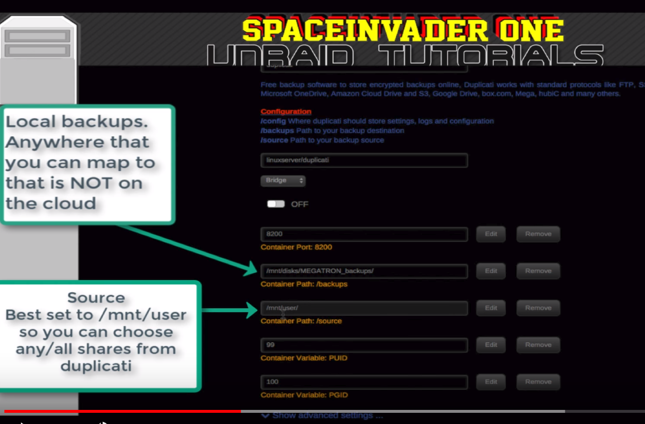

Before I hit Apply, I have been reviewing the Container Setup because I don't want to lose my setup. Now, this might have nothing to with anything, and may not impact my setup, but I really don't understand hosts, paths, etc. The reason I was able to make this work originally is because I watched one of SpaceInvader One's excellent tutorials.
Here's the video I followed, and his setup is far simpler (I took a screenshot of his settings), and I would have copied his exactly (am 98% sure)
But yet, when you look at my settings, there are 4 Host Paths, so the Container was probably updated since he did his video.
The ultimate question is should I hit Apply, or should I be making some more adjustments to ensure my old setup will return intact?
thanks, once more. I think we're just about at the end of this!
Ok. Great thanks for everyone's help so far. I will begin my study this weekend of dockers, hosts and paths and come back to this thread when i have more insight.
Ok, all is now well in my unRaid set up.  I couldn't actually decipher where the config files were for duplicati, so I made a complete backup in case I overwrote anything. Then I learned about paths within dockers and it made sense, and I could see that my old settings were correct. So I hit apply and everything came back up just as it was.
