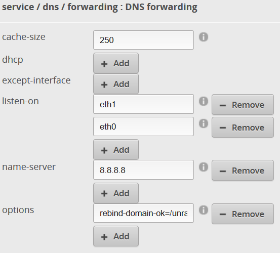

i have been trying to provision an SSL certificate. I have recently installed a new Ubiquiti Edgerouter 4 which i have successfully configured to allow unraid.net domain.
I have two unRAID servers, One can provision & update DNS cert.
The other server will not provision a certificate, I get the error 403 the router has rebinding enabled.

Deleted ssl folders from both servers, deleted the entry from edgeOS GUI (rebind-domain-ok=/unraid.net/) restarted router.
Tried to provision without the option, they failed as they should. Added entry again from GUI not CLI, restarted again, they both provisioned first time.
Who knows.
I use ubiquiti myself,  I have had similar issues with CLI on some firmwares not fully committing unless I commit twice (kind of like the AP set-inform needing to be sent twice. fwiw.
