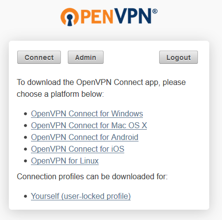

You need to load a VPN user profile into your VPN client on Android.
Login to the VPN server as an admin user.  When the screen below appears, download a user-locked profile.
If you setup your Open-VPN server with your No-IP server name (which you should have done), this profile will be configured to connect to that server name with your admin user credentials.
Import that profile into your Android OpenVPN client.  On my iPhone, I had to email the profile to myself and open it from email.  The Android probably will let you import directly from the client.

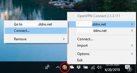

Here's what it looks like on my Windows 10 laptop with OpenVPN client and two users profiles (for two different unRAID servers) installed:
Since I have two servers, from the OpenVPN client, I pick the one to which to connect via the downloaded user profile from each server.
