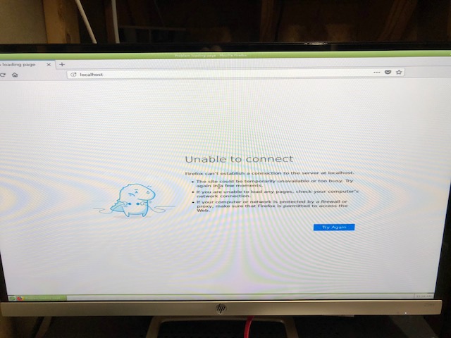

I believe this is messing up unRAID.  Symptom: unRAID will not load the GUI.  I get all the way to the choosing to boot using the GUI.  After i enter my password the screen flashes and attempts to bring up the main unRAID GUI menu.  I get an error Unable to connect (exactly what you see if you cant get to a web page).  I troubleshot the following.  From my unRAID console I can get to google and ran a speed test successfully.  I can see my unRAID server (Flash folder only) on my home network.  Also, i noticed when unRAID is loading i used to see throughout the load all 16 of my drives.  Now I only see 4 drives (which I verified through the LSI configuration utility 1 LSI controller has 4 drives connected and the other 2 LSI controllers each have 6 drives connected) so it appears unRAID is only seeing the 1 LSI controller.  Again I'm wondering if this is because the config file I saved from my original hardware build only had one LSI controller with the 16 drives attached?

When I chose option 2 GUI it goes through loading (again when loading and looking at the console it only reports 6 drives) then it starts to open the unRAID GUI and fails with Unable to connect (see image below).
Thanks,
RS

Ok.  I changed USE_SSL from auto to no.  Did not fix the issue of booting into the unRAID GUI.  I log into root put in my password the screen attempts to open up unRAID GUI and instead I get unable to load page (top left corner in url bar) and main screen message of unable to connect.  I ran diagnostics (log attached) and found these errors?
