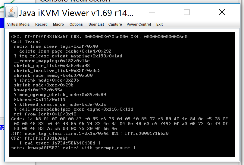

My unRaid server has become increasingly unstable. It has random lockups. It is unresponsive to anything. I can't pull diagnostics when it gets in the state. The best I can do is grab logs after a forced shutdown and a screenshot of a remote KVM session while it is locked up. I've attached it. If I run "Fix Common problems" in troubleshooting mode, it never seems to lock up. I am going to try again, but this is getting frustrating. It seems to have all started after upgrading from 6.3.5. I am currently on 6.5.0.

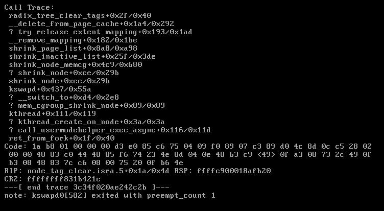

It just happened again right after I upgraded to v 6.5.1. It had barely run for 10 minutes before it became unresponsive. Once again I could not grab any logs only a screenshot of a remote KVM session. This is getting really frustrating. It works fine when FCP plugin is running in troubleshooting mode.

Unfortunately the potentially useful stuff has scrolled off the top of the screen. I'd run Memtest86 from the boot menu for 24 hours or so then run FCP in troubleshooting mode again.
