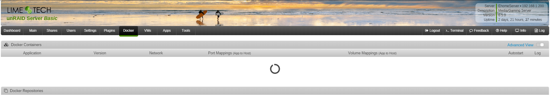

Randomly my docker apps will not load on the dashboard. The only way I have been able to get them back is to completely reboot the server.
Navigating to the docker tab just shows me the loading icon and never does anything more. Docker.thumb.PNG.809183efe13093b2616e669070733e74.PNG
Stopping and starting the docker image in settings window has no effect.

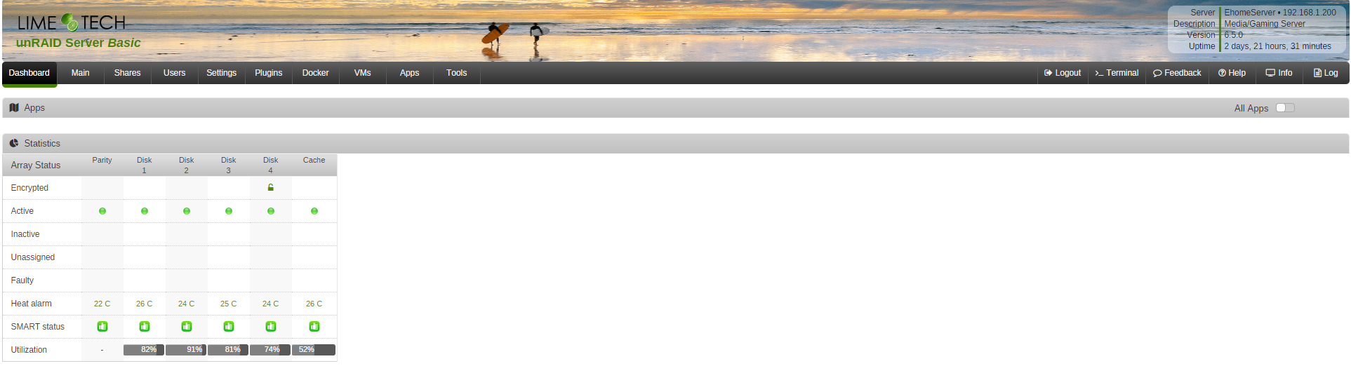

Looks like that might have taken care of it. Thanks!
