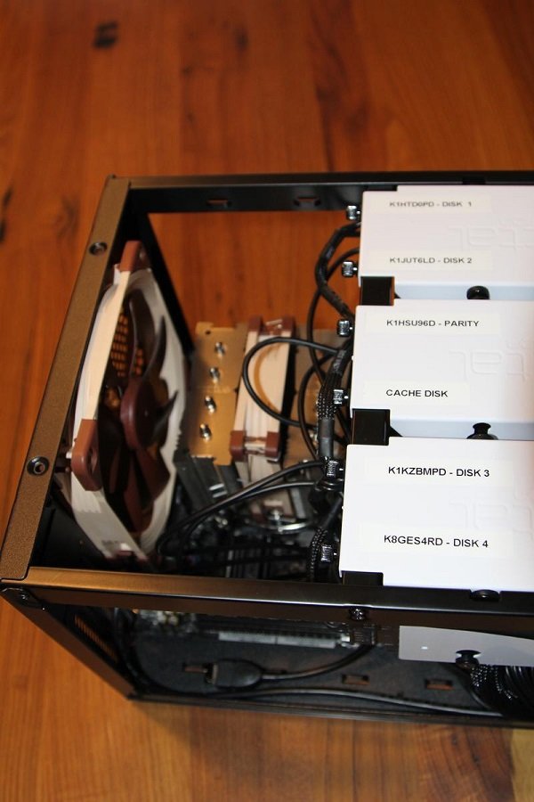

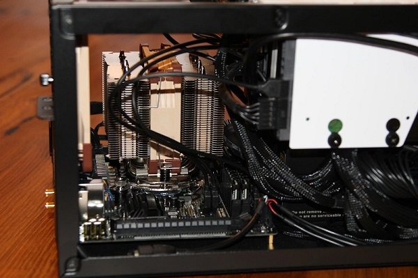

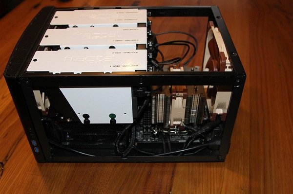

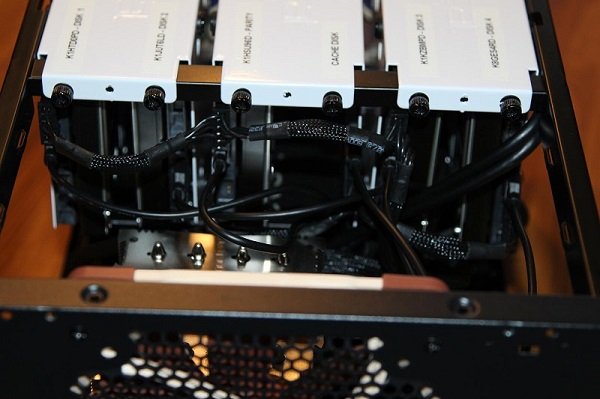

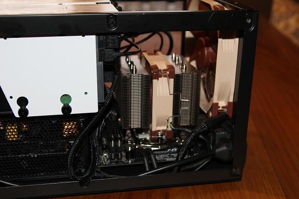

Thanks for the offer. Parts should be arriving on Tuesday (sadly, I missed the cutoff to have them delivered for the bank holiday weekend. I ended up switching to the H370 version of the board since I'm not going to be overclocking and it was slightly cheaper but also offers more USB 3.1 ports if I need them. It looks like the layout of the board is nearly identical.
Looking at your photos, it looks like you're going for a similar plan as me, I'm going for a Noctua tower cooler and replacing the case fans with Noctua PWM fans. I really like the idea of labelling the drives on the brackets, will have to steal that idea. I didn't order the exact model of M.2 to PCI-e adapter I'd linked earlier as it was out of stock, I'm getting a Silverstone version instead which I'm 90% certain is the identical board but with Silverstone branding. That will let me run 2 500gb 960 EVO M.2 cards for the cache. For the PSU, I was looking at Corsair but then started looking at the size of the PSU and for smaller options. I've opted for a Seasonic 850W Focus Platinum. It's overkill for the power I know, but I wanted to get a Platinum rated PSU if possible. It's also smaller than the Corsair PSU, it's not much but I figure every millimeter will count in this case so short of going for SFX it seemed like a good idea.
Which Noctua cooler did you purchase?  I originally purchased the NH-U9S CPU cooler, but the motherboard power cable was very close to the fan, so to avoid any issues I swapped it out for the NH-D9L.   You should be fine with the PSU you selected as it's fully modular, I went with an EVGA G3 650w PSU.
I went for the NH-U12S to get a little bit more height between the motherboard and the heatsink.

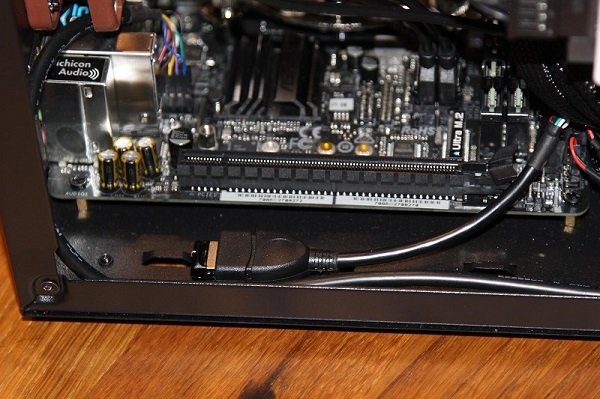

So far the build is going quite well. I had some delays on the parts, but once everything showed up it wasn't too bad getting the initial parts in and booted. I've copied over nearly the entire contents of my old NAS, filling my 8TB drive in the process. I've now pulled one of the 3TB drives from the NAS and am waiting for it to preclear so that I can add it to the array and complete the copy. Yes, this is a little bit sketchy running the NAS with no redundancy, but there's nothing that's irreplaceable that's left if I do suffer a drive failure before I get the last stuff copied over. Once that's done I'll be able to properly install those 4 drives and get myself up to a very nice 20TB array with another 500gb of cache. I know I'm going to have to redo some of my cable management once I install the drives, but with the modular PSU, it's pretty easy to unplug from the PSU and reroute those cables in a more sensible layout.
The x4 PCI-e to M.2 card worked flawlessly and showed up fine in the BIOS. Being close to the big vent on the side it's also staying nice and cool, although I am still running with the case open so I don't have any final temperature data yet. The M.2 card on the motherboard is not quite so lucky, I'm going to see how it fairs with the case closed in case that helps some air to flow closer to it rather than just rising out of the open top. At one point, after doing some heavy copying and a mover operation it did get up to 47C so that's a bit toasty given that ambient was only around 21C at the time. If it still spikes in temperature once everything is assembled then I'll probably look into an M.2 heatsink to keep it a bit cooler.
You need to start worrying at 85C for a M.2 SSD.  My 950 Pro runs at 55C idle, for example.
You can apply a thick heat pad to the SSD, I used one from a dead NUC that I stuck between the M.2 and the motherboard in my main machine, basically uses the motherboard as a bit of a heat sink.  Works pretty well for free.
Another option if you have a single sided SSD is to use a strip of copper tape to spread the heat.  Stick it to the back of the SSD where there's no components.  I used copper tape designed for keeping slugs out of plant pots, it's super cheap in DIY or garden stores, and has enough adhesive on it to be insulated from the SSD.
Edited by HellDiverUK
Good tips. I knew that 47C wasn't too much of a concern, but it did get flagged from the default temperature warnings. My only concern was that this was with the case open so I'm going to keep an eye on it once I close things up since the other M.2 on the PCI-e adapter was still running at a nice 21C, it definitely highlighted that's an area of the board that's not getting any airflow at the moment.
With an open case, some of the more flush comps might be getting LESS airflow than in a closed one.  Remember, the fans aren't drawing properly with the case open.  I ran into that a few builds back and obsessed about it for a while before closing it up, then saw the drives warm by a degree or two and the MB sensors drop by up to 10 degrees.  Air will flow in the unrestrained path, in a small open case that often negates the effect of the main system fan on items down by the motherboard.
Not saying it /will/ change, just advising to plop the case lid on and run a parity check for an hour or two before you make any conclusions
