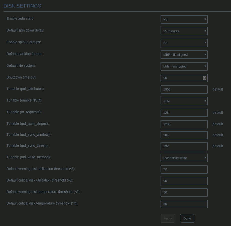

I have unencrypted XFS array disks, read/modify/write dual parity and a BTRFS RAID-1 cache pool and I believe I'm seeing a similar effect as you. I'm in normal boot mode with plugins running so it isn't a "clean" test, but I'll post my results when they're complete.

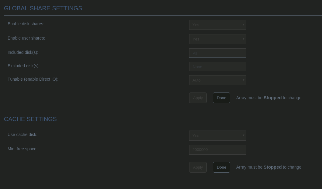

Yup... Nearly identical in safe mode. I did see shfs spike occasionally when writing to /mnt/user, though only for a few seconds at a time. I'll post in the Defect reports tomorrow evening.
If direct IO is disable try again with it enable (Settings -> Share Settings)
Tried again changing direct io from auto (which allegedly just turns it off) to on, and get about the same write performance with worse read performance.
That's weird. if anything it should be faster, but I'm not seeing any performance issues whit v6.5 and reads/writes, and I always use /mnt/user, so no idea what the problem is.
I ran the test again with Direct IO enabled (and parity calculation set to reconstruct write this time) and got this with unRAID 6.5.1-rc6:

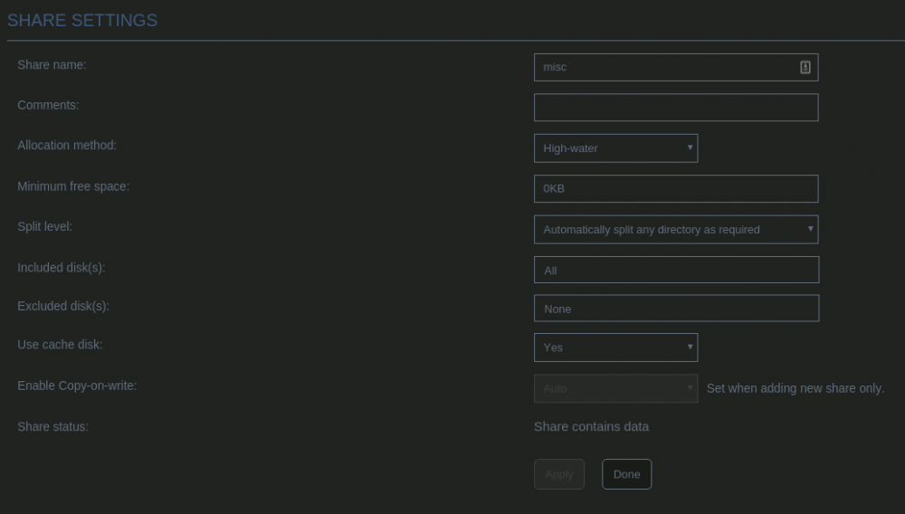

I should also note that misc is an actual share on my system (the place to put stuff when there's not a place to put it). It's pretty basic share, use the cache and move when applicable. All the usual defaults.

Looking at the results, direct IO seems to have SOME effect, but I'm still seeing about half the write speed vs writing to the disk directly.
Edited by jayseejc
Add results for direct IO disabled.
I will add that enabling direct io seems to break a bunch of my docker containers. Stuff like Plex and influxdb just won't start.
If you rebuild the containers with direct disk references instead of user share references it will work. Instead of /mnt/user/appdata, set it to /mnt/cache/appdata. This assumes that the appdata folder in question resides on your cache disk.
On 23/04/2018 at 2:57 PM, John_M said:
I'm curious to know what Direct IO actually does. I'll try to find what Tom wrote about it at the time.
Well, it was first introduced in unRAID 6.2.0-rc5 and was quite controversial at the time. It seems the aim was to improve write performance to the cache when using 10Gb/s Ethernet. It was tested and questioned. The only information about it is in the GUI help and here. Specifically,
It only should be used if you are using 10gbps networking and aren't getting full transfer rates when copying data to user shares.
I've turned the option back to Auto because it doesn't seem to fix the issue. Never mind 10 Gb/s speeds, we're not seeing 1 Gb/s speeds. It would be nice is some other people were to test this and comment.
