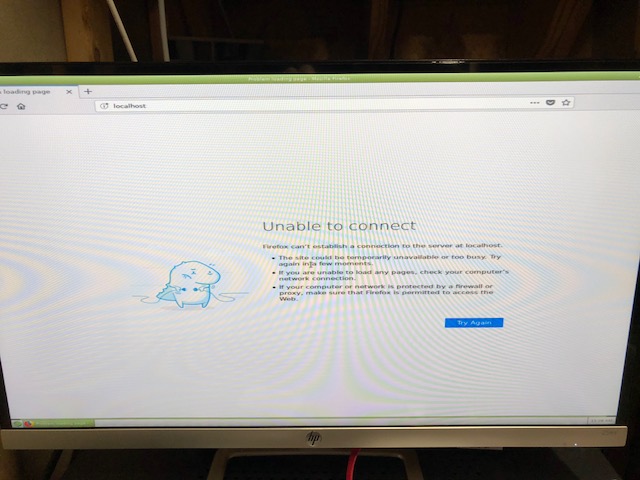

Does anyone know if the following error would cause the unRAID GUI not to load after logging in?  I get the error message unable to connect just like you would see if you were trying to connect to a webpage and your network cable was unplugged.  And yes my network is good.  I can connect to google from the unRAID console.
Apr 23 13:03:27 Watson root: unable to load certificate
Apr 23 13:03:27 Watson root: 23319456118464:error:0906D06C:PEM routines:PEM_read_bio:no start line:pem_lib.c:708:Expecting: TRUSTED CERTIFICATE

I did see these interesting lines in your syslog though, safe bet it's related to your error:
Apr 23 13:03:27 Watson root: Starting Nginx server daemon...
Apr 23 13:03:27 Watson root: nginx: [emerg] PEM_read_bio_X509_AUX("/etc/ssl/certs/unraid_bundle.pem") failed (SSL: error:0906D06C:PEM routines:PEM_read_bio:no start line:Expecting: TRUSTED CERTIFICATE)
Apr 23 13:03:27 Watson emhttpd: shcmd (24): exit status: 1
