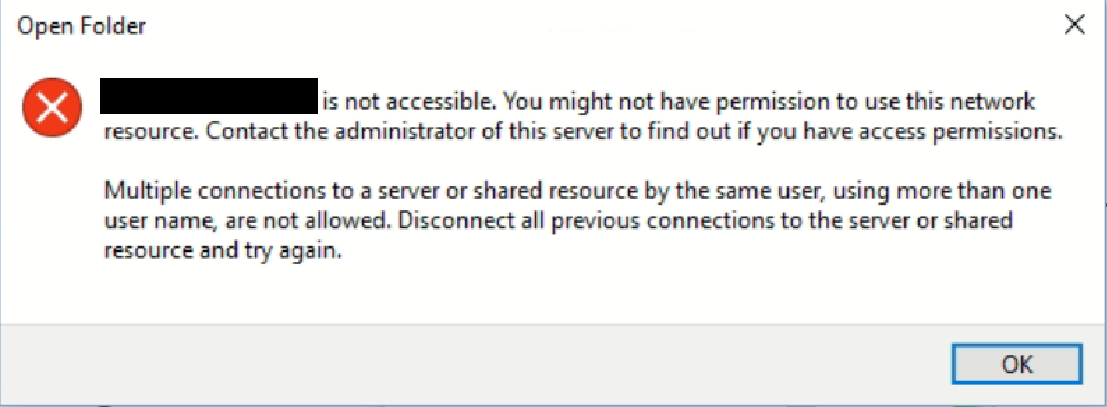

On the Desktop, I get this error:

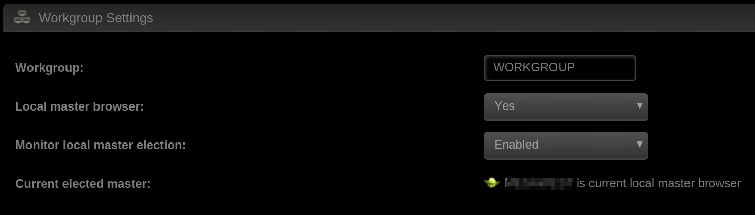

I have tried resetting the permissions with "Docker Safe New Perfs" and I've enabled Samba 1 and 2 on both PCs and theyre both Windows 10, so NTLMv2 should be on on both. There are no Windows credentials for me to delete. I am also running the Local Master plugin, and the server is the local master.

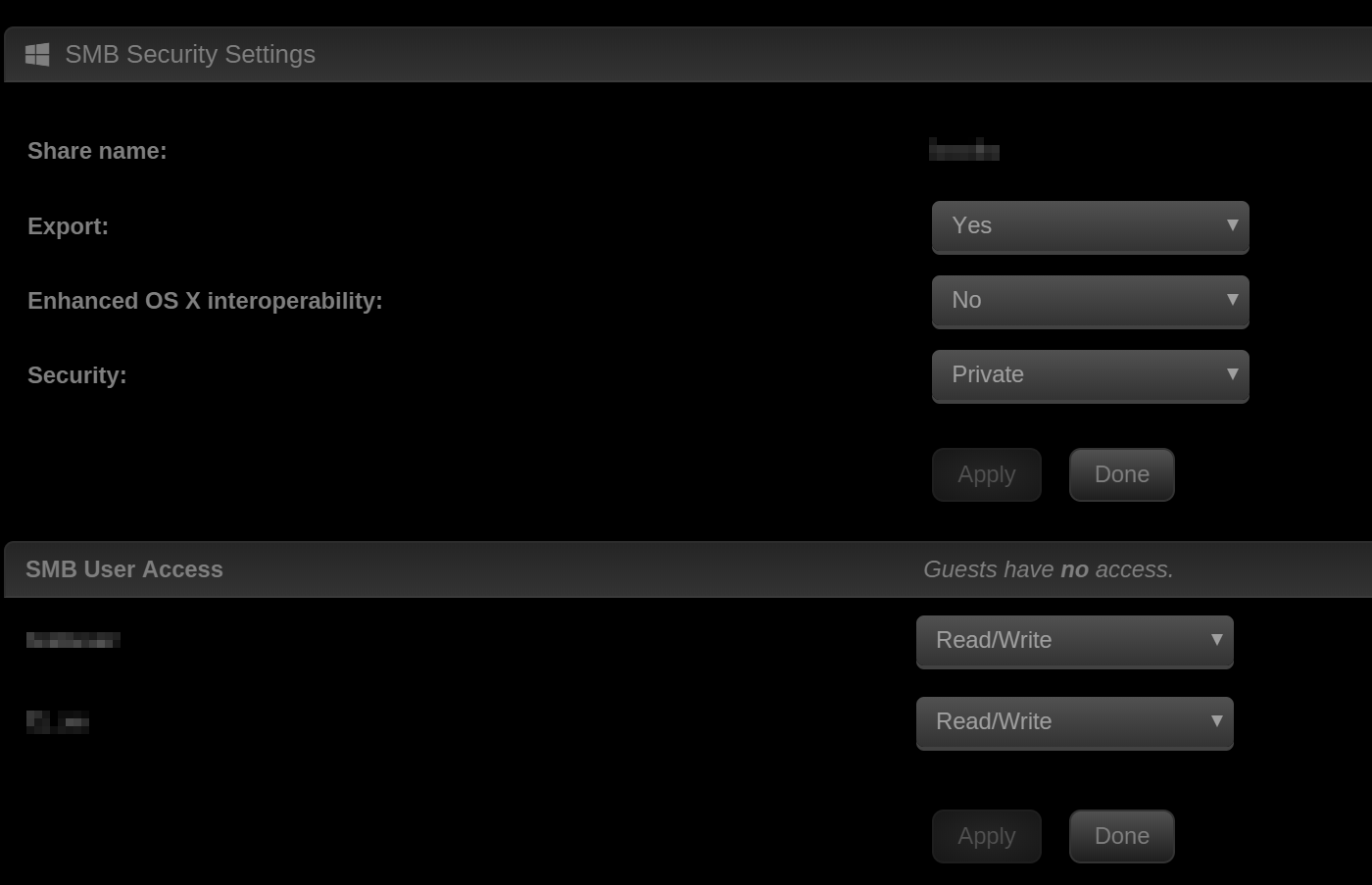

Private Share settings:

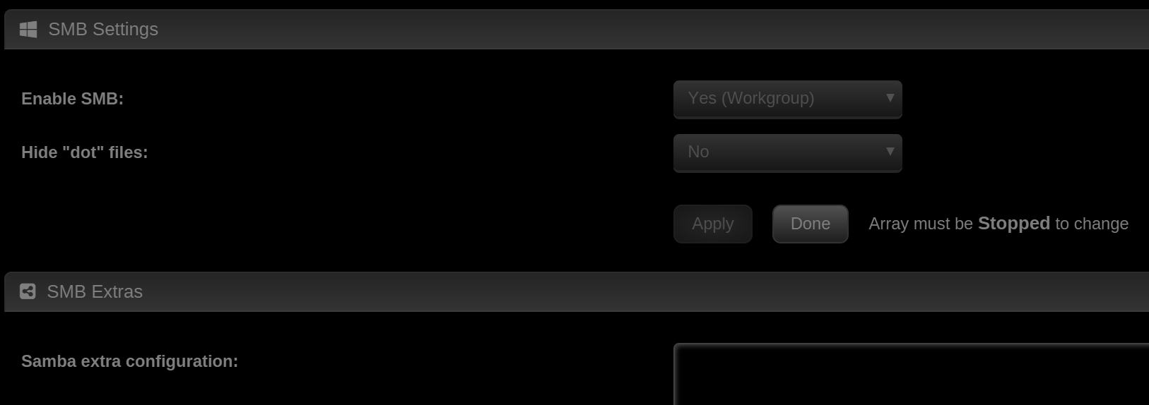

SMB settings:

Yes. The issue is when you first access the server, windows is being "helpful" and sending a set of credentials. Since some of your shares are set public, ANY credentials will work, and windows remembers that, and will refuse to use any other credentials for that server, locking you out of the private share.
You need to be sure that the FIRST server access is to the private share, so the credentials will be forced to be the correct ones. Any shortcuts, drive letter mapping, ANY connection to the public share that are in your user profile on windows will prevent you from connecting to the private share.
It's a stupid windows issue, if you are truly stuck and need access and can't get it to work, you can work around it by using the IP address so windows thinks it's connecting to a different server.
