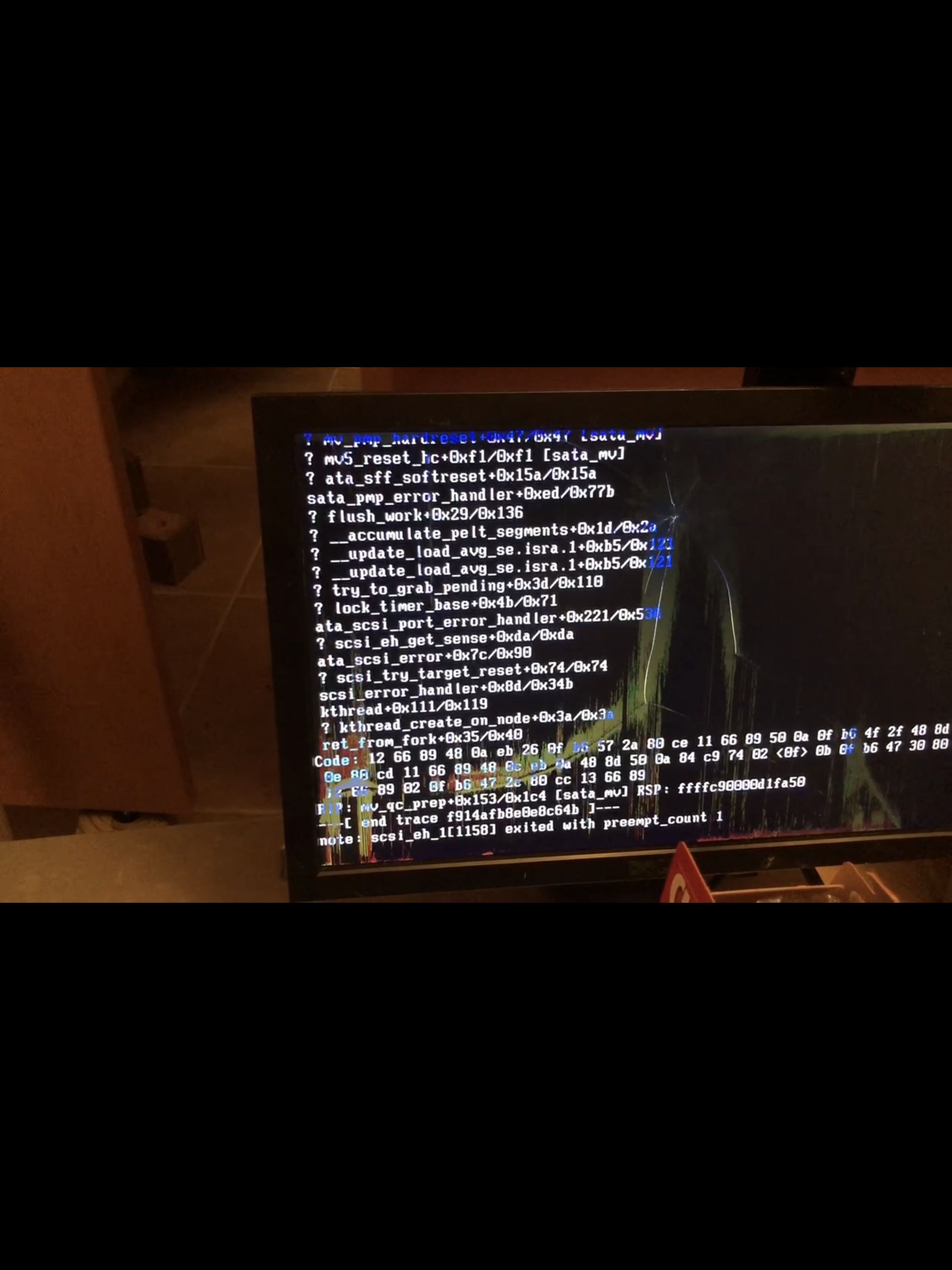

I also am unable to upgrade to any of the stable versions 6.40 - 6.52 my  server is a 24 bay norco with super micro X7DBE-X MB with 3 super micro AOC-SATA2-MV8 I have 24 SEAGATE ENTERPRISE EDITION 4TB HDD. Before doing the online upgrade I followed all the steps. When it boots it shows the controllers and attach ed drives in bios but not during the unraid boot.
The only way I can boot any ver above 6.35 is by popping the latches on all the drives and it boots straight in the GUI and when I plug in any of the drives as soon as it tries to mount it throws a drive. error up and  even tried booting server with just one drive at a time and no matter what it errors out. Soon as reinstall 6.35 I am back to perfect running system .
Same even if I use the usb tool and write any ver to a fresh or same flash. Any ideas? The attached screen shot is best I got of what happens just before the system locks up.
thanks for any ideas or thoughts.
4 hours ago, sicfreak said:
Any ideas?
There are known issues with the SAT2-MV8 controllers and newer kernels and/or newer devices, best bet with be to upgrade them, or you'll likely be stuck using older releases and/or older disks.
On 6/3/2018 at 3:20 AM, johnnie.black said:
....best bet with be to upgrade them, or you'll likely be stuck using older releases and/or older disks.
Well that's a bit of bad news.  Those controllers are Pci-X, so you're really saying- 'replace your entire server'
