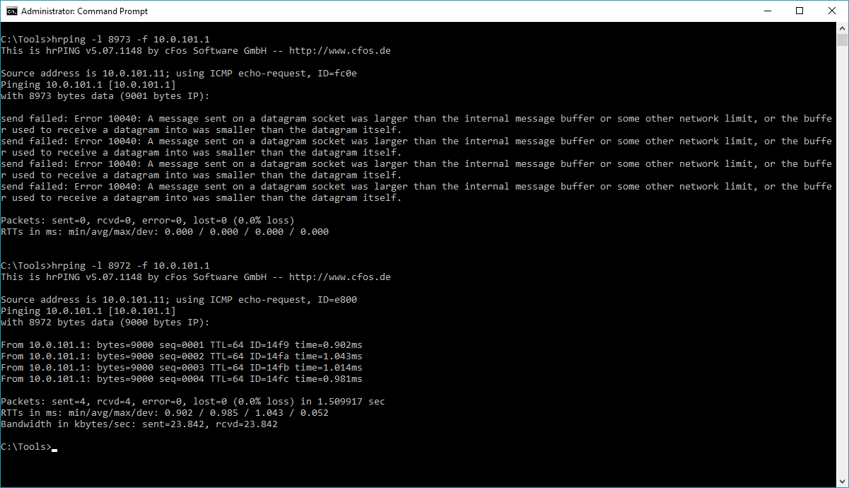

Is an MTU of 9014 supported at both ends? The standard for 10G Ethernet is 9000 bytes and some NICs don't support higher values.
The only option my Asus NIC gives above ~4k is 9014 & my unraid box nics support it.
I suspect someone at Asus failed the network courses.
Their figure 9014 is probably MTU 9000 + 14 bytes ethernet header. But the 14 bytes of the ethernet header shouldn't be counted as part of the MTU.
They are definitely not the only ones.
This setting gives a MTU of 9000.
The ethernet layer includes a 4 bytes FCS checksum at the end, making it 18 bytes in total. Somebody didn't pay attention when defining these values. Not to speak about the confusion it causes.
Edited by bonienl
M$ doesn't explicitly claim that their figure 9014 is the MTU. It's ok to talk about 9014 byte large packets when talking about jumbo frames - as long as the number 9014 isn't claimed to be the actual MTU value.
