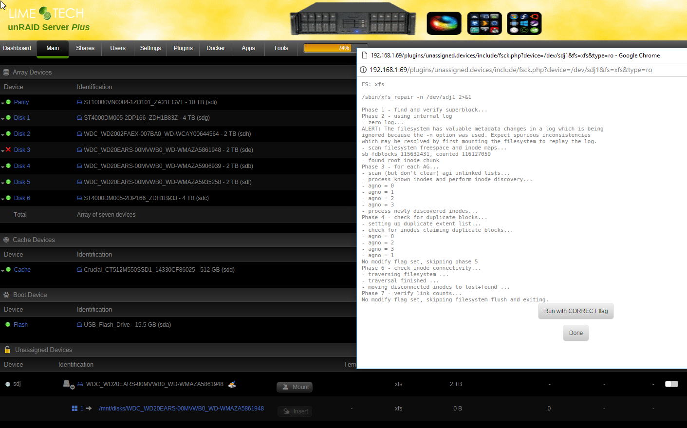

Device is disabled (faulty drive?) content is emulated, BUT seen on unassigned devices
I've had a drive x'ed out for a few days, had a replacement sent overnight and it's pre-clearing right now.  But I just noticed that the sde device which I would think is faulty, is seen in unassigned devices as sdj...
Now does that mean that the drive is usable but for some reason the sdx is mixed up and unraid can't find it?  Should I mount it and try the scan again, or with the correct flag?
Any idea?
It did have 2 unrecoverable sectors in the smart status for a while and was meaning to replace it ASAP.  I had an unclean shutdown last week where the whole server stopped responding and would not respond to SSH.  Web interface was only responding to clicking the tabs but nothing else, I could not initiate a reboot and/or array stop.
After a force reboot :/ it did a parity check and never noticed that the autocorrect was on in the scheduler...  It did correct some.  The drive stopped working a couple of days after the parity check ended.

Tools - Diagnostics, post complete zip
Disk3 doesn't look very healthy, but current problem looks more like a connection issue, I would still replace it but if you want to try and keep it run an extended SMART test, if it doesn't fail replace cables and rebuild.
Thanks Johnnie!
Well, since I bought a 10tb to replace that 2tb and I need the space, I will definitely replace it, and probably won't use it after, because I agree, it's not very healthy...
I'm hoping its not a dead sata port... my 10tb is almost done pre-clearing so once that's done I'll replace it AND the cable to be safe.
Well replaced and all is well.  Didn't replace the cable but unplugged it and replugged it again to be safe.
