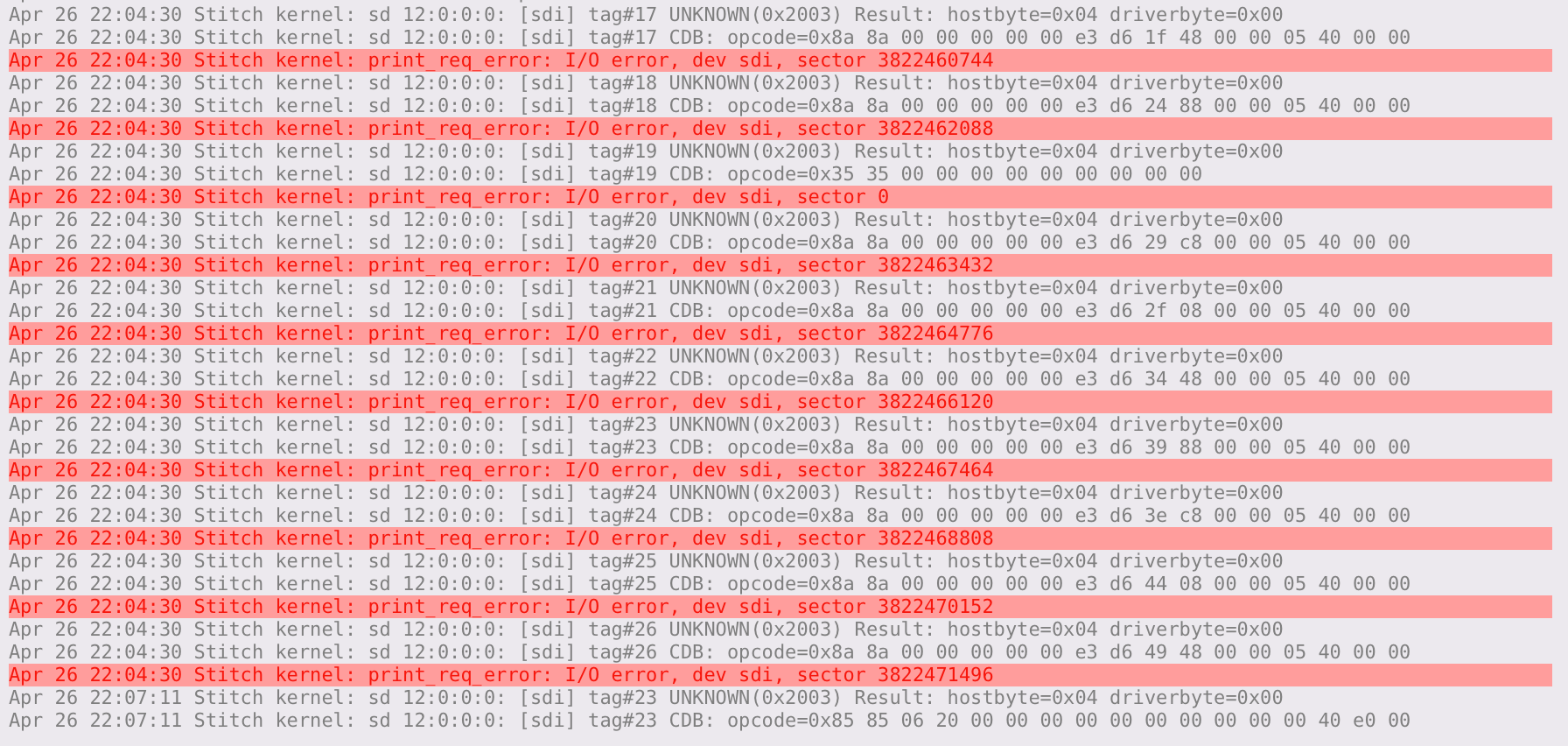

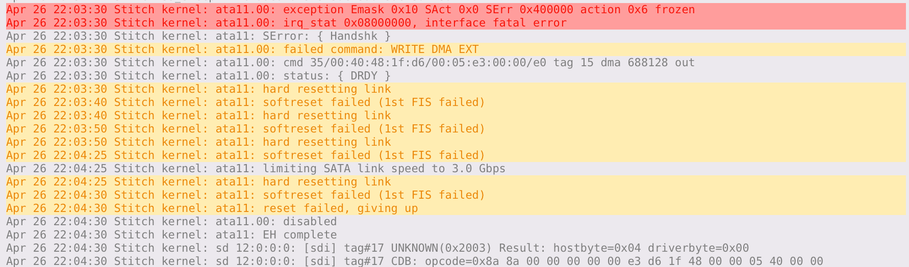

I'm on the latest unraidos and a longtime user. in the last 2 weeks I had 2 dying drives as parity drives?!
first it was a long time used 5TB from seagate and as the drives died, I quickly ordered a HGST NAS Drive 4TB. today it died too!
i noticed it ran 2-3 times at 65° C…
both hdds were connected to the same sata cable and to the same pice card in a n40l hp server. I'm surprised that the second drive made the same exit after just some days of running. brand new hdd
what can I do to verify if its really broken or if I can fix something?
quick help would be nice, thank you in advance. I'm a little bit confused right now

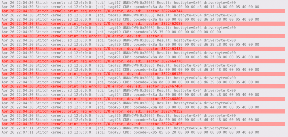

new log pic
syslog snippets are seldom sufficient
Tools - Diagnostics, post complete zip
Parity disk appears to be failing, you can confirm by running an extended SMART test, and if it is it's not surprising considering it ran above max temp:
Lifetime    Min/Max Temperature:     23/61 Celsius
Limit is 60C and it should never be close to that, ideally it should always run under 40C, 45C max.
