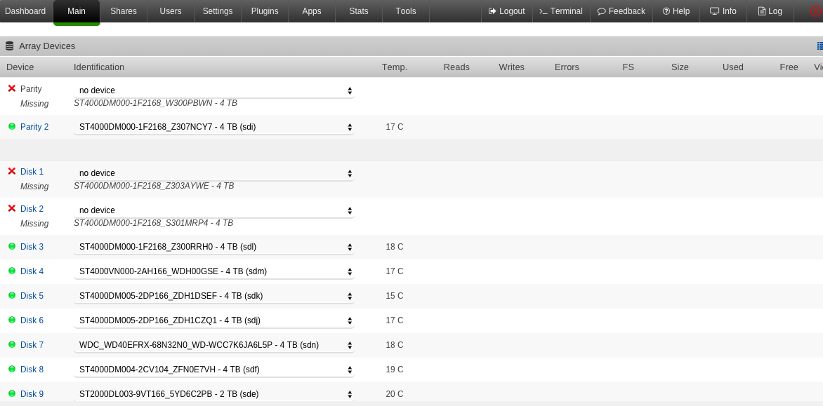

PSU died, took out 1 x 4TB parity and 2 x 4TB data HDD's. What do I do next?
PSU died, and fried 3 x 4TB HDD's! What now?
I installed a new PSU.
The server won't autoboot from the USB anymore I have to select it to boot from each time. I reset CMOS and still does it. Motherboard damaged?
I tried the HDD's on other power and sata ports and get nothing. I tried on them in my other server to see if it will show up as an unassigned device. It's spins up but don't appear as a device.
If the HDD's are completely dead how do I get the server back on with the 2nd parity drive and without the other 2 data drives.

You can't.  You have lost a total of 3 drives, but dual parity allows you to lose a maximum of 2 drives.
So what do I do, I'm guessing I can keep my data on the drives that are left? Do I preclear the 2nd parity drive to use as single parity and then what?

Don't preclear. Just New Config, assign your remaining data disks to whatever data slots you want them to use, assign old parity2 to parity slot. Don't check the box saying parity is already valid. Start array to begin parity sync.
