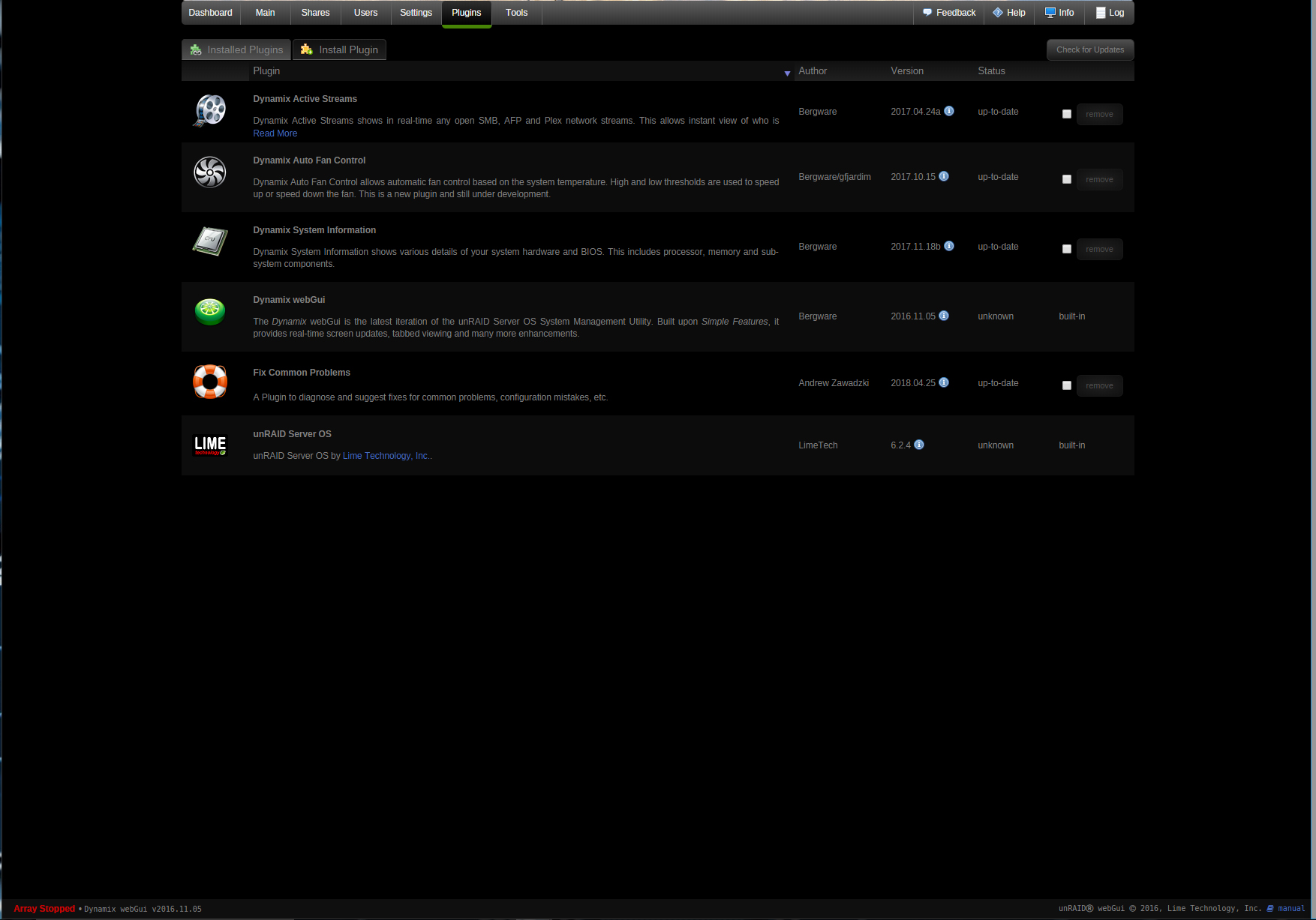

Thanks for the link! I have been through all the steps, but have gotten stuck on this particular one:
  • Stop the array
  • (If 6.3.5 or earlier) Go to Plugins and update the unRAID OS plugin (but don't reboot yet)
When going to Plugins and update for the unRAID OS, I have no option to update.
Click on the 'Install Plugin' tab on this screen and paste in the following:
https://s3.amazonaws.com/dnld.lime-technology.com/stable/unRAIDServer.plg

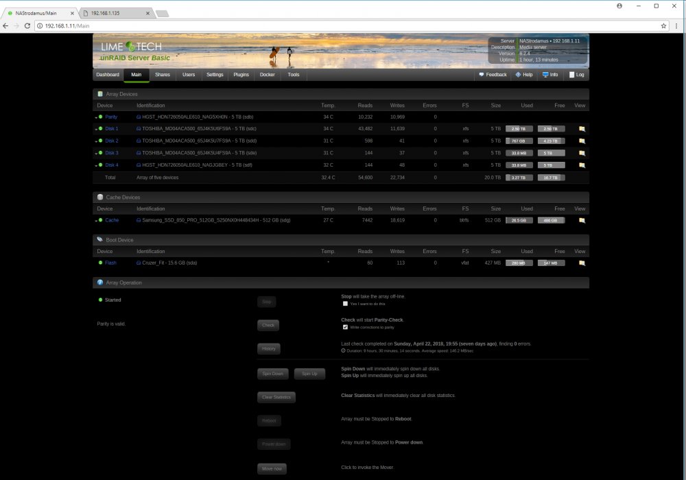

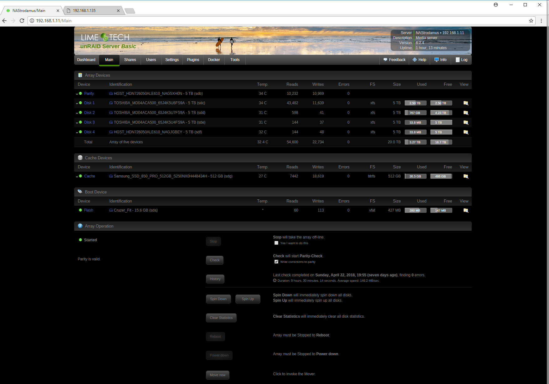

On the Main screen of the GUI, click on the Boot Device Tab/section and see how much is used.
It is a 16gb drive, says 280mb used and 147mb is free. But does say that the size is only 427mb?
