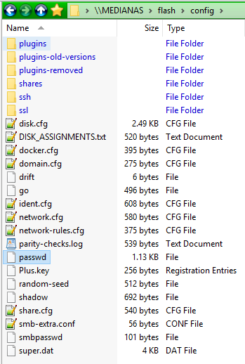

But, if you do decide to start over, all you have to do is erase everything from /config, but leave your *.key file.  If you don't want to have to also reassign your disks, then also keep super.dat

I know a few years ago a similar situation was resolved for another user  (they set a root password and then forgot it so could not log in) by deleting the shadow, passwd and smbpasswd files in the flash drive config folder.
