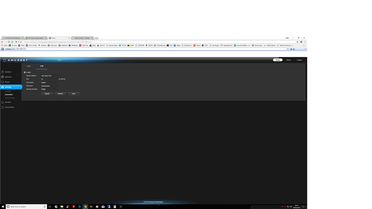

Here is setting for ip camera
I just tried out the builtin FTP server and it appears to give you access to the whole /mnt folder in unRAID, which has the user shares in /mnt/user, but also the individual disks in /mnt/disk1, etc. That is why I suggested browsing the FTP server from your application.
I think you are going to have to tell your application to use "user/Public" if you want to get to the user share named Public.
Thanks for the help, the camera wont let me search unfortunately, also if i try an enter user/Public it gives error saying no symbols are not allowed in path, on my nas i could tell the nas what folder to use for ftp server is that not possible for unraid
