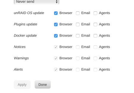

Anyone know how to get rid of this.  Just upgraded to 6.5.1 and can rid myself of it.

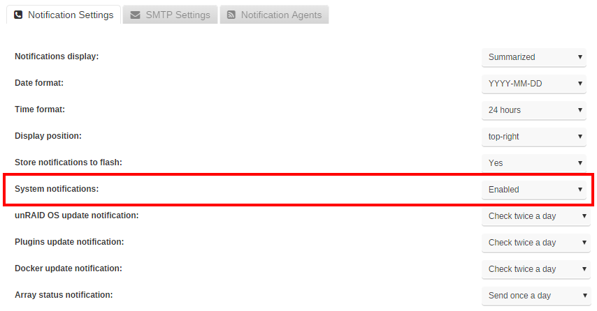

Click on the "here" to enter the settings.  Enable the notifications you need selecting notifation type and frequency but only using browser notifications.  Click apply.  Done.
It's a way to help ensure that users don't miss important notifications from their system, and relatively benign since there's no need to go so far as setting up to send emails for example.
@S80_UK I only have browser selected.  Notice will not go away.
OK - but you also have Never send selected.  Would that make a difference if you set once per day?
Nope.
OK - I would try clearing the settings, apply, and then put them back again, then apply.  Beyond that, someone else may be able to help.  What I described worked for me on my backup server when I upgraded earlier today.
Still present but thanks for trying.

You need to at least get alerts with something other than the browser. The whole point of the warning is to make sure you get notified immediately even if you don't open the webUI. Many users get into trouble because they don't even know they have an issue and they just keep going until they have multiple issues.

Now I'm puzzled - I only have the browser enabled and I don't have the banner anymore.
