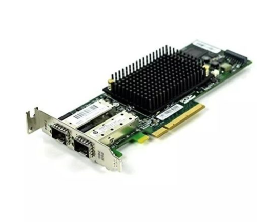

Hi Guys,
quick question.
Did you think this card will be supported by unRaid OS?
PDF: http://www.intelligentservers.co.uk/content/HP-NC550SFP-Dual-Port-10GbE-Server-Adapter-581201-B21-586444-001.pdf

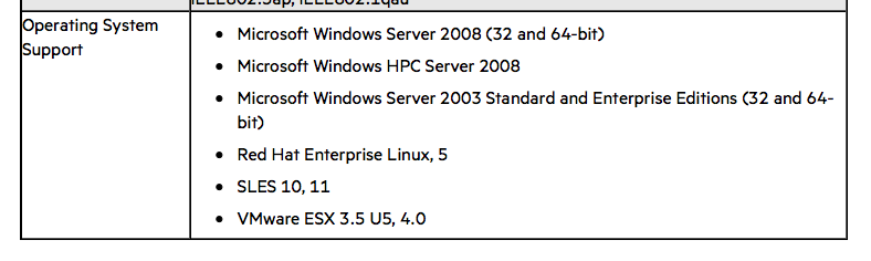

Thanks Connor Moloney for the link. Look in the os support page, looks will work like you said. I think i will have to try.
Did you know if i can have both onboard motherboard 1gb connection and the pci 10gbe running in the same time?
