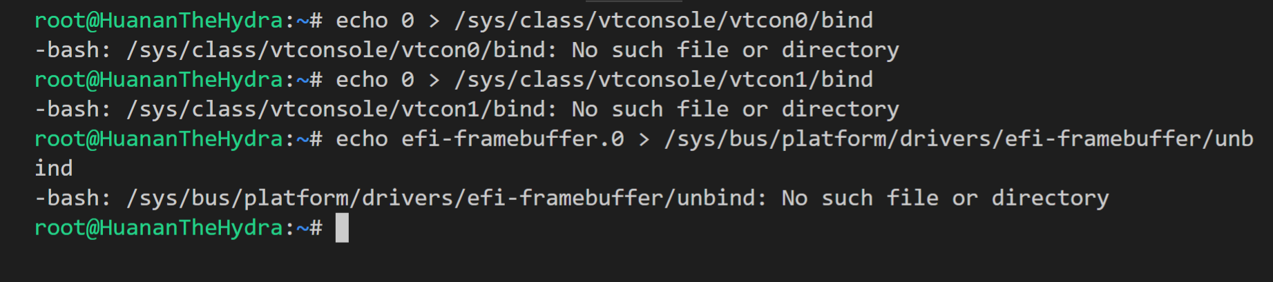

I indeed get a different result when ssh'ed as root. I am still running into issues though.
Last login: Thu Aug  9 19:06:02 2018 from 192.168.1.125
Linux 4.14.49-unRAID.
root@HuananTheHydra:~# echo 0 > /sys/class/vtconsole/vtcon0/bind
-bash: /sys/class/vtconsole/vtcon0/bind: No such file or directory
root@HuananTheHydra:~# echo 0 > /sys/class/vtconsole/vtcon1/bind
-bash: /sys/class/vtconsole/vtcon1/bind: No such file or directory
root@HuananTheHydra:~# echo efi-framebuffer.0 > /sys/bus/platform/drivers/efi-framebuffer/unbind
-bash: /sys/bus/platform/drivers/efi-framebuffer/unbind: No such file or directory
My vtcon* directories do not contain a bind folder.
root@HuananTheHydra:~# /sys/class/vtconsole/vtcon0/
power/     subsystem/
root@HuananTheHydra:~# /sys/class/vtconsole/vtcon1/
power/     subsystem/
Hmm, I'm not entirely sure then. I followed a fix someone else found so I don't really know how they found what to do
Jamie
I am not sure if I needed to restart the server, or have the array stopped, but one of those let me run two of the 3 commands:
Which resulted in a boot without mmap errors, which allowed me to install drivers.
@bigjme I added a user script to fix mmap, it sounds like this fix does not persist on a restart for you right?
Thank you for the debugging steps and suggestions!
Edited by paperblankets

I'm getting permission denied or the folder doesn't exist when I run the commands. How can I rectify this?
Hi @kalfun,
One of these paths does not exist for me as well:
/tmp/user.scripts/tmpScripts/Fix mmap/script: line 3: /sys/class/vtconsole/vtcon1/bind: No such file or directory
/tmp/user.scripts/tmpScripts/Fix mmap/script: line 4: echo: write error: No such device
`vtcon1` in my case does not exist. I have just left the script as is though since the error does not cause damage, and if a configuration change occurs and that console is used I want the script to fix that bind.

Well it was working but now when I SSH in and run the commands (wanted to test it again before adding the script) and I get his:
root@Tower:~# /sys/class/vtconsole/vtcon0/bind
-bash: /sys/class/vtconsole/vtcon0/bind: Permission denied
What user are you sshed as?
The exact script I run is:
#!/bin/bash
Only one vtcon path is valid at a time for me, so I frequently get a `tmp/user.scripts/tmpScripts/Fix mmap/script: line 3: /sys/class/vtconsole/vtcon1/bind: No such file or directory`
Error, but I leave both so my script keeps working if I change video cards or pcie slots.
