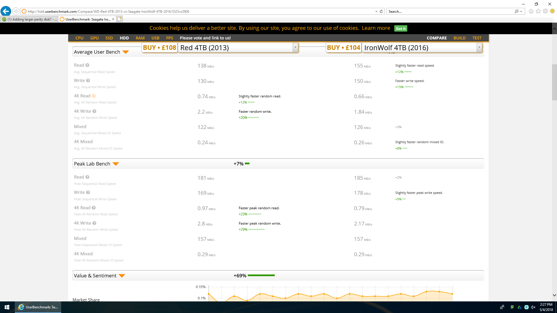

Heres a benchmark comparison for you
Any differences there are mostly irrelevant for unRAID.

Yes true the ironwolf coming out on top by just a few MB/s and if you really need extra MB/s you would probably be looking at different drives anyway
