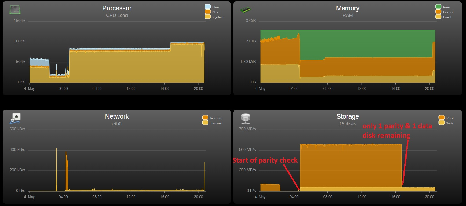

The problem should not be the low RAM (according to the pic I attached).  Nor should it be the bandwidth of the SASLP card (both drives are on an SASLP). It seems that somehow each disk's bandwidth cannot exceed the 50MB/s limit.

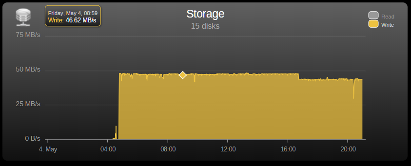

This is the write speed for the parity drive during the whole parity check up to now:

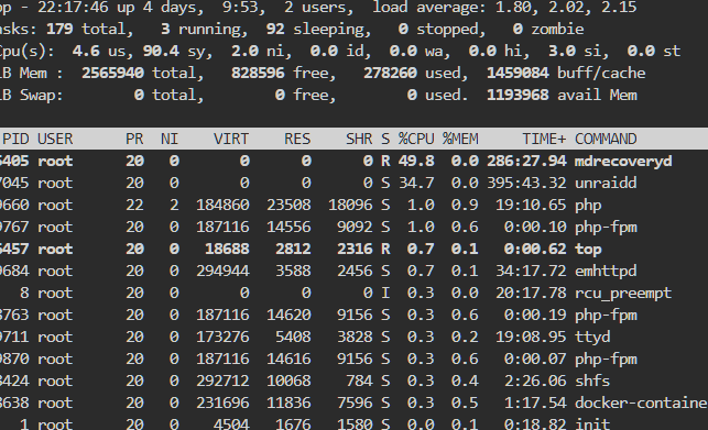

It's CPU limited, look at the CPU usage in the end, it's @ 100%
I though of it, but it seems strange. The CPU usage is 100% when there are only 2 disks involved in the parity check operation and it is lower when all 13 are reading/writing (reaching a collective read speed >500Mb/s. And it is a single core CPU but it seems abnormal for it to be limited at 50MB/s speed per disk.
Yes, because it's going faster per disk, but it's very close (or already) CPU limited before.

If just parity check/sync, the memory usage shouldn't have any change. So pls check does some task run in same time.
May be simple try perform parity job in safe/maintenance mode, 50MB/s speed for 8TB need 45hrs.
Edited by Benson
I think no other task is consuming significant power (I think mdrecoveryd and unraidd should be running at parity check):
And, yes, it seems parity check will last 2 days :(
