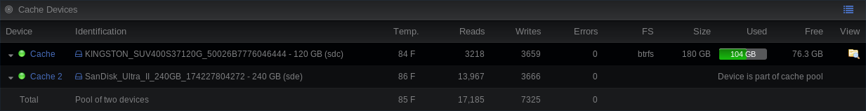

I replaced a cache drive in my pool earlier today with a larger drive following the basic procedure in the wiki:
https://lime-technology.com/wiki/UnRAID_6/Storage_Management#Replace_a_disk
Everyting appeared to go as planned, the new drive appeared to be getting a fresh copy of all the data. The total size was initially reported as 240gb (the size of the new disk I installed) which wasn't correct as the pool initially contained identical 120gb drives. I thought this was odd so I started searching for answers, as the drive was taking new data I saw this number fall so I figured btrfs might just figure it all out in the end. That's apparently not the case and after about 6 hours the size is reporting at 180gb and it appears to be done moving.
Attached is a screenshot of what I am seeing.
Any help would be much appreciated!
Edited by Liggysmalls
Have you done a ‘balance‘ on the pool?
You’ll find it buy clicking on the cache and scrolling down a bit.
Also I’ve read that the reported available size is not correct and you need to realise you only have as much space as what’s in the smaller drive.
Yes I have, it didn't correct the issue.
Seems rather pointless to have this column taking up pixels if it's not expected to be correct. While I understand that the available space in the pool is dictated by the smallest drive I can't help but question if it's actually functioning properly when I see something like this. This value must be polled from somewhere that's clearly not returning the expected value for this configuration. Is the interface wrong or am I about to experience some catastrophic failure?
