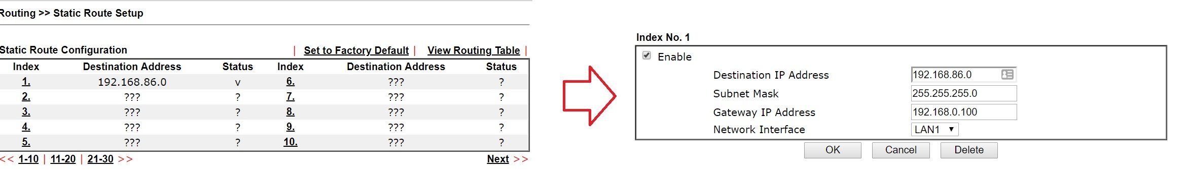

I have a rule to allow gwifi subnet to see my "main" network. (to access from 192.168.0 to 192.168.86)
COULD that be the problem? In gwifi you cant setup literally anything.
I understand it that way that everything what want to go to 192.168.86 will get redirected to the google wifi address in the subnet from the router.

I think now, maybe i should switch gwifi direct after draytek router and then switch, so i dont have a need for that rule and all devices are on the same subnet.
