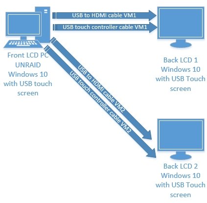

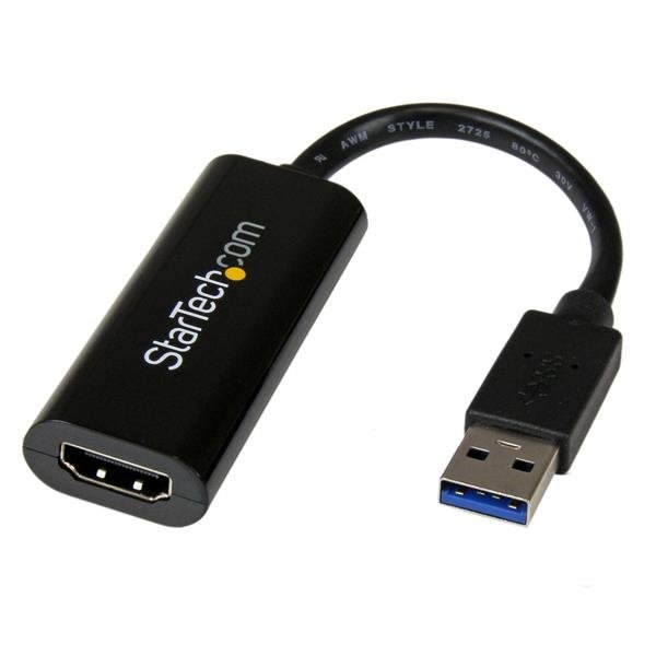

I have a car project that I am deciding wither to use a core i5 NUC with USB 3.0's and allow that to power my front LCD (10.1" touch) and the 2 back monitors (also 10.1" touch). Problem being with this setup is that I do not know if UNRAID can do a USB pass-through with the graphics so that I can make 2 Windows 10 VMs for the back 2 LCDs while running the main windows 10 on my front LCD.
So it would look something like this:
Front LCD Unraid Windows 10 Local Intel Graphics |--> Windows 10 (USB 3.0 to HDMI Video) via HDMI cable--> Back seat LCD 1
                                                                                           |--> Windows 10 (USB 3.0 to HDMI Video) via HDMI cable--> Back seat LCD 2
If this is not possible then it looks like I will need to purchase a Intel Compute Stick for each of the back LCDs in order to do something like that above.
Any input would be great (especially if you've done something like the above already before) :)

There's no problem with drivers as the usb-hdmi is passed through to the windows VM. The only "gotcha" is that you have to set up the VM via VNC because windows won't load the drivers until after its set up
