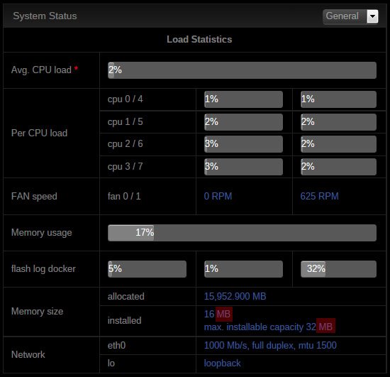

Cosmetic "error" in Dashboard
...shouldnt this be called GB? ;-)
Edited by Zonediver
In my setup it is GB...So I am not sure what is wrong with yours...
Agreed. Same here.
hehe... funny ;-)
4 minutes ago, Zonediver said:
hehe... funny ;-)
I wish it would run on 16MB with the way ram prices are right now ?
Can you post the output of
dmidecode -qt17
dmidecode -qt17
Here it is ;-)

Ok, found the cause. The incorrect unit is displayed when a parity check is running.
Corrected.
Thanks for reporting.
