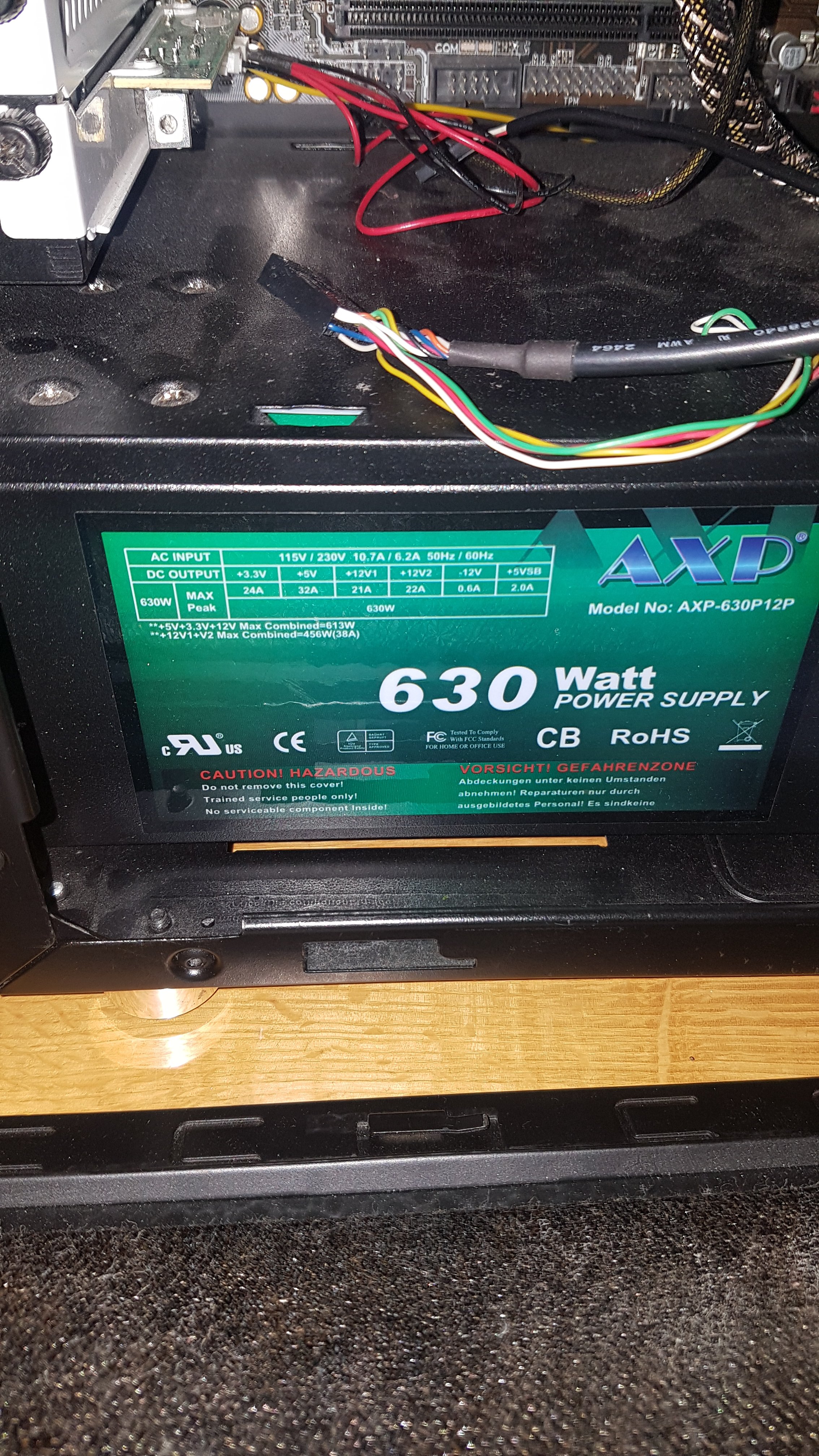

Hi John,
I'm using quite an old psu. While it's technically not a noname, I've never heard of the brand. I guess this is probably the culprit? The ssd is bought second handed, but it got less than 10k hours on it, which from my understanding is quite alright.
Best regard.
Hmmm. I think the biggest problem with that one is the fact that it has split 12 volt rails. I would not be happy using it. Only ones with a single high current 12 volt rail are recommending. A bad power supply is a false economy and can cause all sorts of otherwise unexplained problems. Have a look at the PSU Tier List and choose one from near the top. I use only Corsair AX, RMx and SF models, depending on the application.
The power on hours of a disk or SSD are irrelevant as long as it is in good working order.
