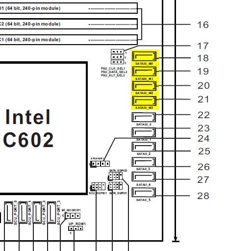

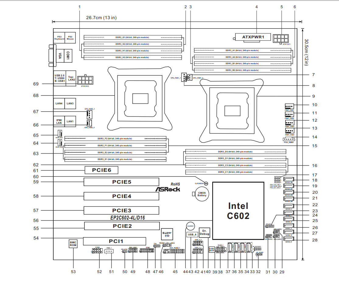

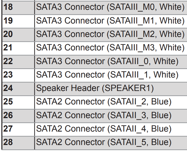

Question for both Bob and Johnnie regarding the Asrock ASRock - EP2C602-4L/D16.
Both of you have mentioned not to use the Marvell controller, which I understand due to the issues experienced with unraid. Now, un-be known to me, I thought the 4 blue SCU ports were what we were talking about, but I have just looked at the manual and there seems to be some confusion over the SATA ports.
On the website it shows this:
Storage
SATA Controller - Intel® C602 : 2 x SATA3 6.0 Gb/s, 8 x SATA2 3.0 Gb/s, support RAID 0, 1, 5, 10 and Intel® Rapid Storage 3.0, NCQ, AHCI and "Hot Plug" functions
Additional Storage Controller - Marvell SE9230: 4 x SATA3 6.0 Gb/s, support RAID 0, 1, 10, NCQ, AHCI and "Hot Plug" functions
But there is a discrepancy in the manual itself:

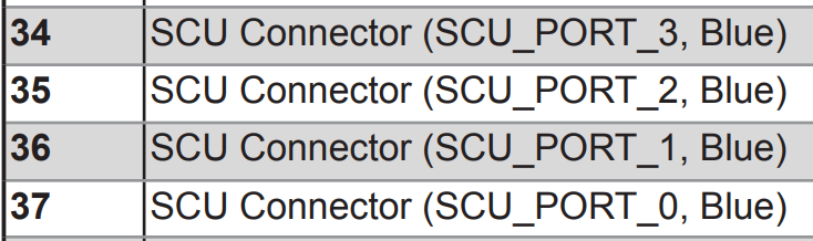

I know that ports 34 - 37 are the ones to be avoided as they are the Marvell Controller, but its ports 18 - 21 that are confusing me. If you look at the above description from the website, it mentions 2 x SATA3 and 8 X SATA2, yet the above image quite clearly states ports 18 - 23 are SATA3. I understand ports 22 and 23 are controlled by the Intel chipset and are indeed SATA3, but ports 18 - 21????? This then got me thinking, if Asrock can't get there descriptions right, then are ports 18 - 21 also running on a Marvell controller? If so, then I have ports 18 - 28 filled at present and it doesn't seem to have caused me an issue. I have been running unraid for over a year now and use it with the Emby docker as a media server.
No, those are the SCU ports, Marvell ports are the first 4 white ports 18-21
Edited by johnnie.black

There are a number of things that are somewhat confusing on the 4L/D16 board one of them is the Marvel ports the other is the dedicated IPMI lan port.
Marvel SATA ports:
IPMI dedicated lan port:
I would have though that #3 above would be the IPMI port - seems more logical to me.  Just like the SCU ports not being the marvel controller.  But that makes a little more since since there are circuit traces on the MB for an addition 4 port to bring the SCU ports up to 8 if they were attached.

I would put the SSDs on the two white ports closest to the blue ones they are Intel.  Only the 4 white port at the end farthest away from the blue ones are Marvel.   Those 2 white ports are Sata3 like the Marvel ones.  Your HDDs will not need Sata3.  It's only recently that HDDs (spinners) have been able to approach the Sata2 speeds.  Basically the blue ports are all Sata2 speed on the MB. @johnnie.black could tell you about SSDs and the IBM M1015 for sure.  But I believe the M1015 does NOT support the trim operation on SSDs on many/most SSDs.  Enterprise level SSDs are most likely to support the operations needed for TRIM on an M1015.
Correct, use the 2 Intel SATA3 ports for the SSDs, SATA2 is enough for HDDs.
Yep, I realised my mistake after making that post. The 2 SSD's on the 2 Intel SATA3 ports, use the 4 SCU SATA2 ports for the 2 Parity drives and 2 unassigned drives. Then use the 4 Intel ports for 4 of the drives for the unraid array, then use 8 ports of the expander for the 8 drives in the unraid array and the external port for the Startech external backup.
