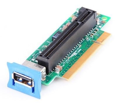

I'm back once again with a question regarding the M1015. I'm just preparing to install this along with the SAS Expander this weekend, and have just taken the M1015 out of the packaging.
I hadn't realised until removing from the packaging that the board comes with a PCI-E FRU43V7067 expansion adapter and not a bracket. This isn't a problem as I can accomodate this, but the question is to do with what looks like a USB port on the expansion adapter. Anyone know why this is there as I thought the card would get its power through the pci-e slot? Do I need to connect a usb cable to this port?
You don't need to use that adapter.
Hi Johnnie,
So are you saying ditch the adapter and not worry about the bracket and just let the card sit in the socket, which is my thought after I posted the above, or should I really look at getting a bracket to fit? Using the adapter or not, the card isn't going to be physically held to anything anyway.
The SAS Expander does have a bracket which of course is essential as it has an external SAS port.
I missed that there's no bracket, IMO it would be best to get a bracket, it should be easy to get one on ebay, the adapter is another possible point of failure.

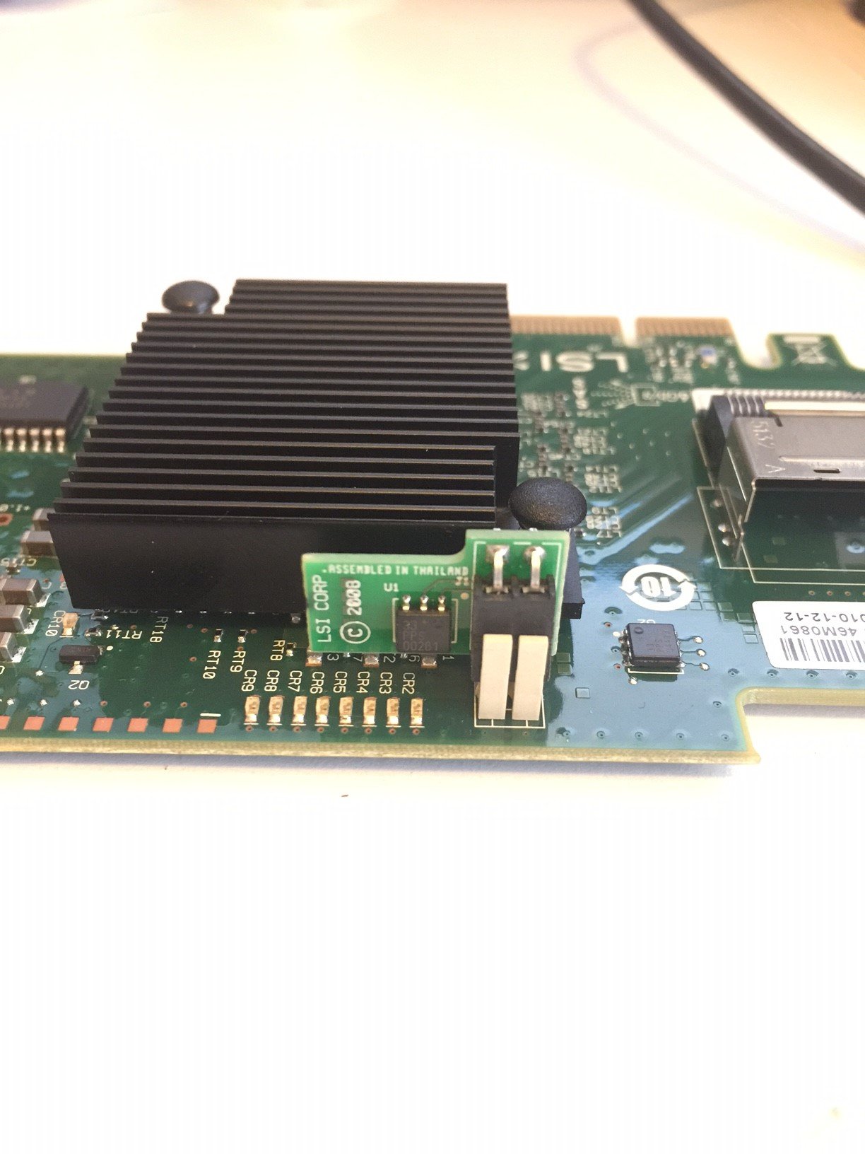

Just come across an oddity though. I have 2 x IBM M1015 cards, although my intention is to only use one with the SAS Expander. However, I've just noticed one of the cards has a small daughter board attached whereas the other doesn't? What is this daughter board and is it needed:
Edited by apefray
Never saw that before.
Hmmm, I take it i should probably use the card without the daughter board then, lol!
