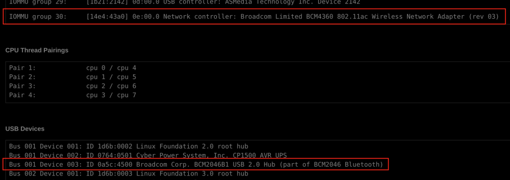

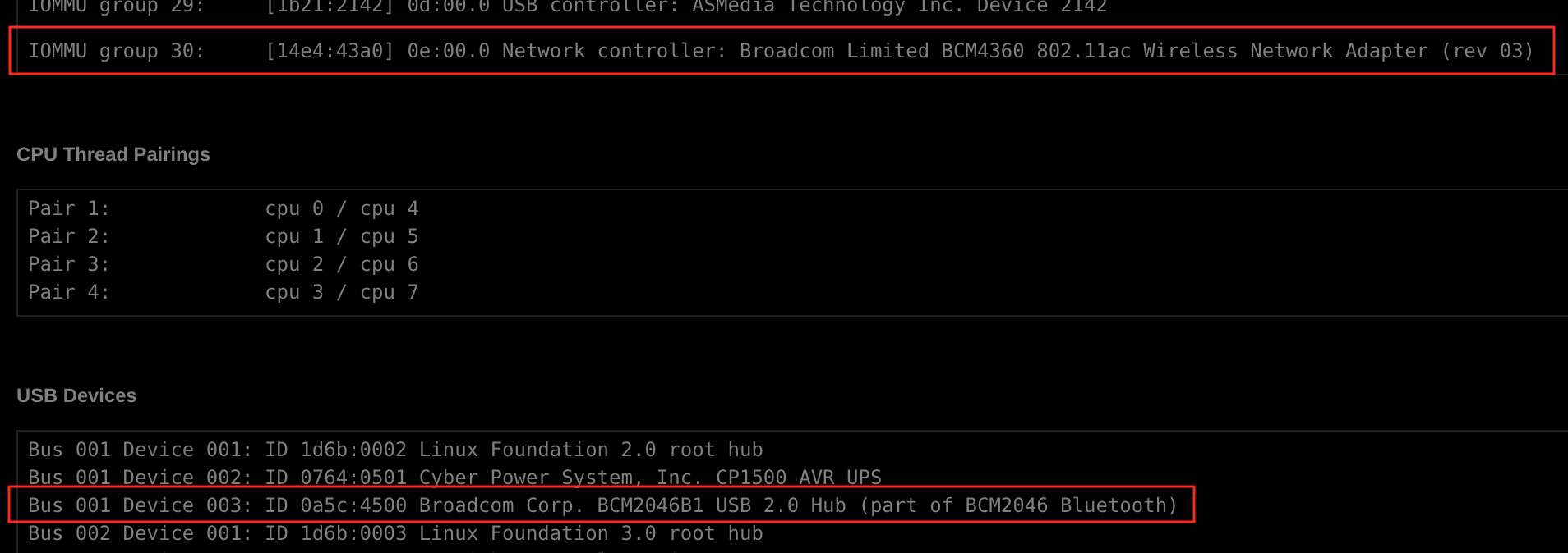

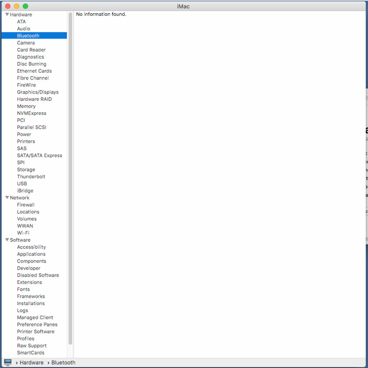

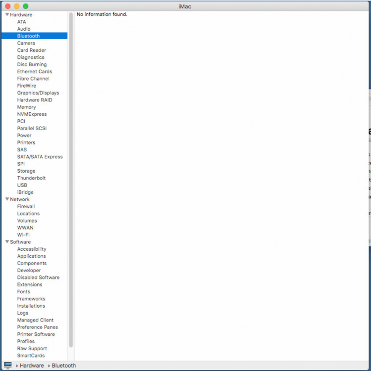

I've installed High Sierra by following Spaceinvaderone's tutorial. I'm able to pass pretty much everything though and get it all working except the bluetooth portion of my BCD94350CD card. I've passed both the PCI & USB portion through to the VM, but am having troubles getting it recognized by HS. No bluetooth devices are showing up in the system report (see attached screenshot).
Below is my XML:

Try setting the usb device to managed='yes' in the xml. All my usb devices are set to yes.  Also i have one of these card shipping to me now, did you have to stub the pci part from unRAID for that to work?
managed='yes'>
Edited by david279
managed='yes'>
Did you get your card working in High Sierra?
I wound up buying the wrong card. FV 8801, Bluetooth worked but no wifi.
