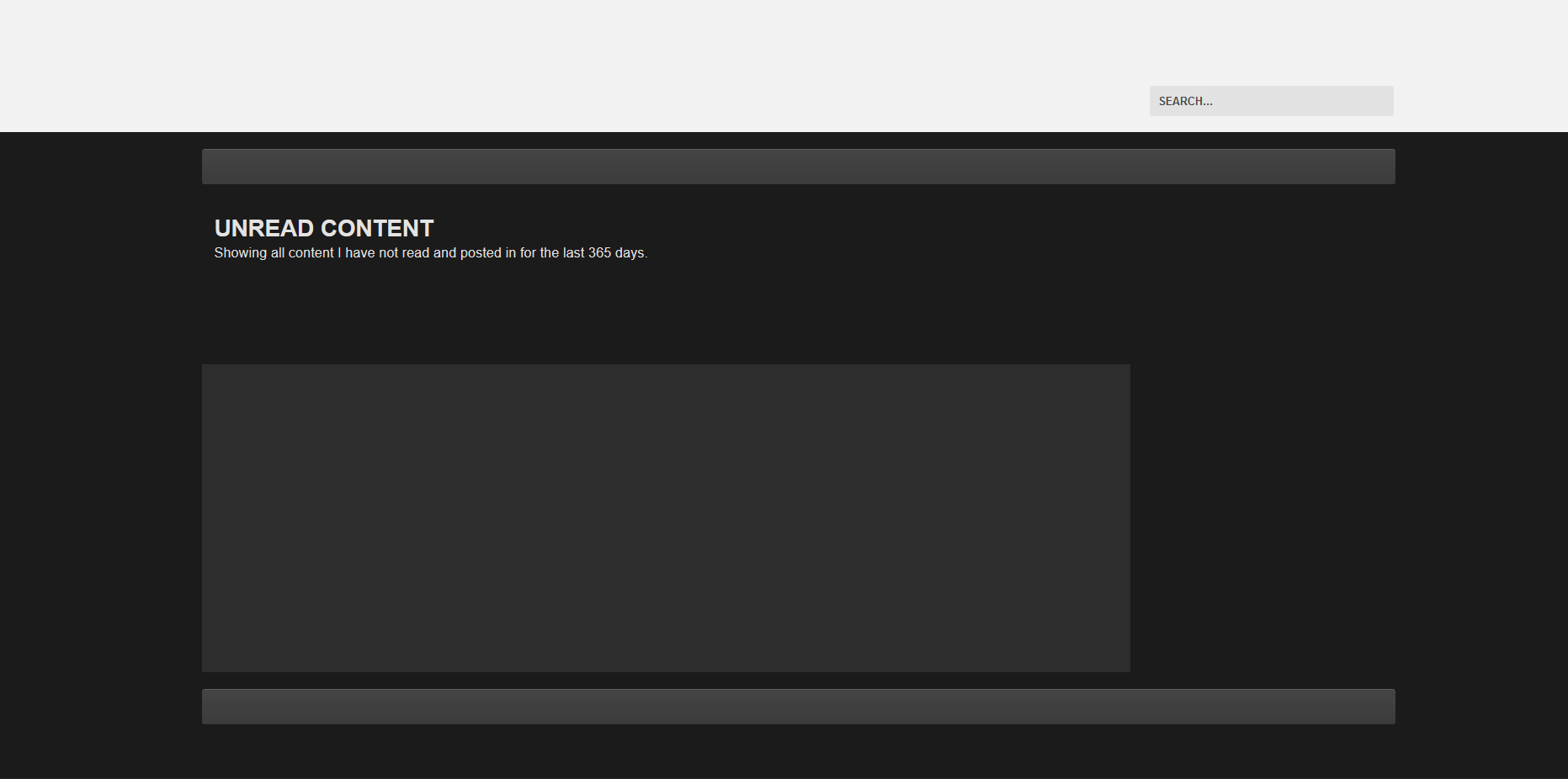

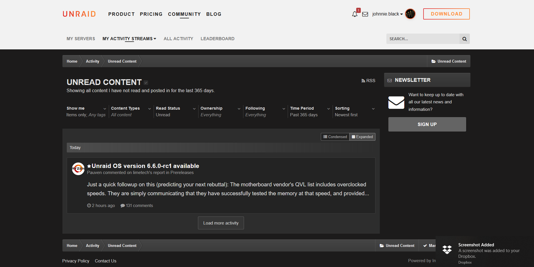

September 4, 20187 yr Author Forum has been noticeably slower for me since the update, e.g. when I go back and forth to the unread post list it always takes two beats to display the page, first just shows some parts: Then after a second or two the rest appears: This is rather annoying when reading many posts, and it happens both at home and at work, with different computers and ISPs, so believe the problem is not on my side.
