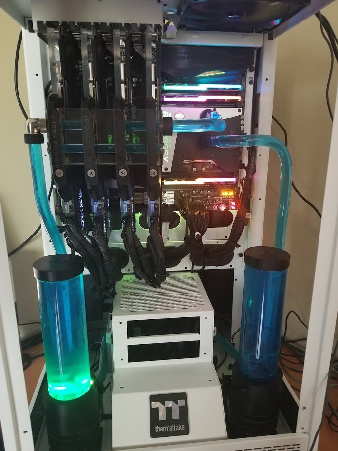

Ok, So I have a Gaming Rig which I specifically built for the purpose of VR + LAN Parties in my Livingroom. Concept is to pull up 2 folding tables out, plug in 4 Monitors, Keyboards and Mice and have a 4 person LAN Party going.
The board (Asus Rampage V Ed 10) has 4x PCI-E16 slots with 4x 1080tis . The board is capable of running all 4 and all 4 was running fine on a previous Windows OS (Before Unraid) so I know hardware compatibility wise is fine.
This is how I have it laid out
VM1 (Main VM) <- Does not load
Nvidia 1080ti 02:0:0 > Monitor 1
VM2 (Gaming VM) <- Loads Fine
Nvidia 1080ti 04:0:0 > Monitor 2
VM3 (Gaming VM) <- Loads Fine
NVidia 1080ti 05:0:0 > Monitor 3
VM4 (Gaming VM) <- Loads Fine
NVidia 1080ti 06:0:0 > Monitor 4
This is what I've observed.
VM 2,3,4 will load without issues, and upon initial boot of UnRAID, Monitor 1 will show UnRAIDs CLI. When VM 1 is started, Monitor 1 conks out then turns on again (as if to get signal), backlight comes on, blue light comes on, then loses signal, and blue light turns orange (to show no signal) again.
I have tried adding VNC to VM1 so that I can also see what is happening, and when attempting to connect to the VM via VNC (and the monitor which is still showing no signal), the initial starting splash screen shows (the logo for the Virtual Driver before windows starts loading) but seems to be frozen there. No spinning circles that windows typical shows before boot.

VM 2,3,4 during all this works fine and independent of this issue.
Sometimes VM 1 will shut down on its own (Maybe its timing out on the boot?)
Board only has 4 slots for GPUs so I cannot add a 5th crappy GPU to put UnRAID's CLI onto it. Long story short. 5th PCI-E GPU is not an option, Everything has already been Waterblocked. Id be OK with getting a USB VGA Card if there was a way to set it as the Default GPU for UnRAID to solve this issue.

Thanks John,
BIOS ROM fixed it. You put me on the right track.
This was the Video I used to walk me through the process

Yes, it was resolved.
I am running it without issues on 4x EVGA 1080ti FTW3s
I only had to apply the VBIOS to the First card, the other 3 work fine without
I've only tested with 4x VMs with 1x 1080ti going to each VM, I haven't tested 4x 1080ti going to 1x VM
I am currently on a different rig, trying to get 2x 1080tis going to the same VM, but I am struggling with an issue with similar symptoms, but different problem. That Thread is Here.
Excuse the Cable Management (Or Lack Thereof) in the Pic. It's still a work in progress and I've yet to receive the cables I ordered from Cablemod.
