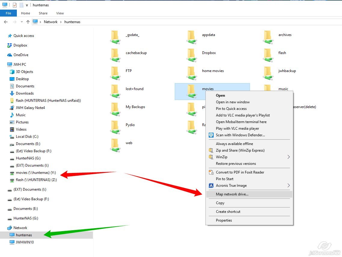

I tried this.  It does not seem to make any difference.  From the start, I can access the unraid server by typing in \\[servername].  As you can see in the image below, when I type in the name, then it shows up in the File Explorer Network section (greeen arrow - it is not there until I type it in the search bar).  I've also been able to map drives (red arrows).  After  a start of the service, no change.  Are you able to see the server in the network section right after the Win10 PC boots?

I check and I had the 'client' side of SMB 1.0 started, but no the 'server' side.  Not sure why that would be.  Made the change and I'm seeing it now.  Perfect!
Glad to hear it is working again.  After every major feature update, you may need to re-enable SMB 1.0/CIFS again.  It is often off by default after major updates.

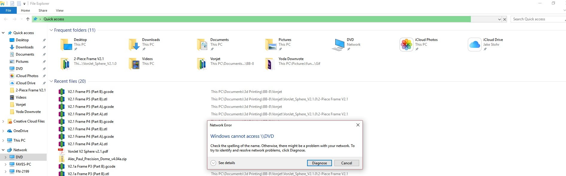

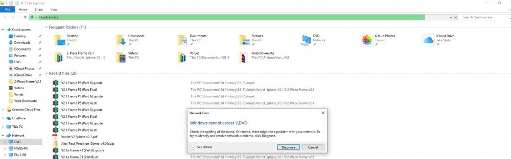

Like I said before, I can see the server just fine, but when I try to access it I get a network error (see attached photo).
Any suggestions on how to get past this?
In the back of my mind, I seem to recall that   DVD    is a reserved name and can not be used for anything else.
Unbelievable... I finally got it to work my completely disabling SMB2 and SMB3.
Disable/enable SMB2/3
Now everything is fine again.... till the next time Microsoft has a bright idea!
