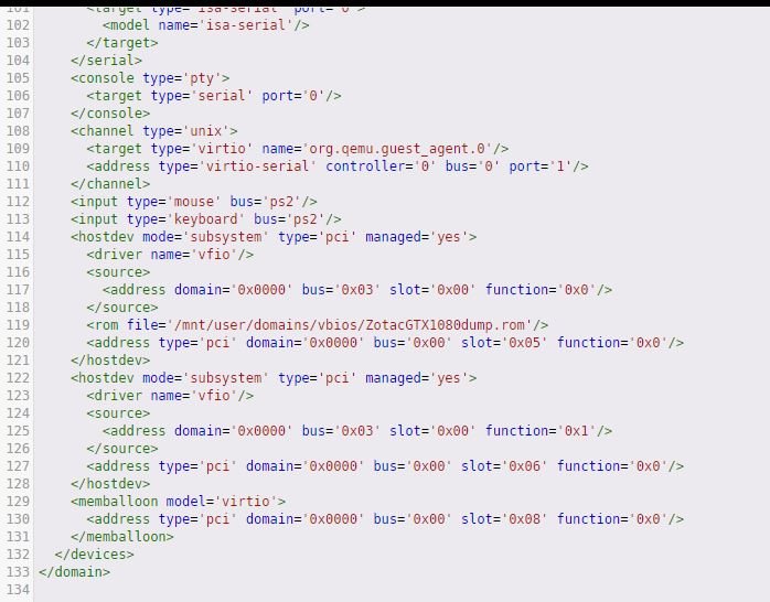

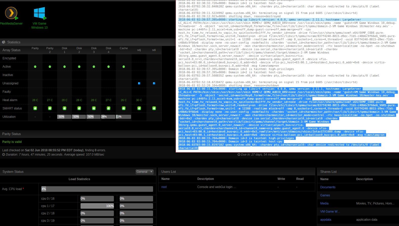

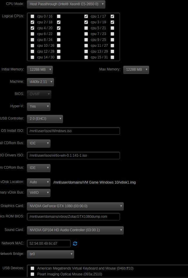

Having this same issue with VM not working with GPU pass through.
My windows 10 VM works perfectly till i try to pass through the single GPU I want to use. I notice when starting the VM, with a GPU assigned to pass through and a vbios path listed, the first of the VM's assigned CPU cores will shoot up to 100% and freeze there, the rest of the VM's cores stay at 0%. If i try to pass through the GPU with out the vbio pathway listed i can get into the VM with Remote Desktop Connection but not splashtop which just goes to a black screen after i log in. But even when seeing the VM through RDC if i try to launch a game or anything that uses the GPU it will fail to launch. Just screen flick to black for a second then come back to desktop. device manager shows no issues with the gtx1080 or driver.
This happens regardless of how many cores are assigned. I have left core 0 alone in all tests and instances for UnRaid to use. The motherboard is set to source the onboard vga first. I have tried changing physical slots removing all other PCI equipment. I've run memtest for 24 hours (no errors). Used online vbios files for my cards modified to work per the guide linked below and its related videos from online sourcing and gpu-z locally. renamed the files to be recognized by the gui interface in VM edit as well as assigned it in the XML editor. i tried all combinations (minus with VNC). put in multiple cards to see if one would pass through, nope. I am seriously scratching my head here.
System as is: https://pcpartpicker.com/list/vW6h7W
I haven't rebuilt the VM or a new one. The system and VM were origionally created on a Supermicro board but it didn't have the PCI slot for a full sized graphics card so I swapped to the Asus zp9a-d8 motherboard then tried the pass through. Could there be an issue with the VM being created on the old board and trying to GPU pass on the new motherboard? If so why does VNC work no problem?
This is past my paygrade i think so hoping someone has an idea or maybe a theory... every thing else works perfectly ...but if it doesn't pass through the GPU i wasted money and hardware.
I've attached pictures of the sytems hang up and the vm log at the time. xml and gui set up of  the VM and vbios files. along with the last 2hrs of system logs during this.

Edited by jlruss9777
added the picture showing cpu hangup with vbios & vm log

Im having the exact same issue with my log hanging at the same point, with a core at 100% cpu utilization. Was this ever resolved? I've tried new VM image and that didnt resolve.
Update - I was able to resolve the issue by removing the gpu bios from the vm config and disabling hyper-v. I guess it was a bad bios file (from techpowerup) so I am now going to try dumping my own bios using gpu-z so I can run headless. Currently I get a black screen unless the HDMI cable is connected to the TV (from the GPU being passed thru) at the point the VM is started.
