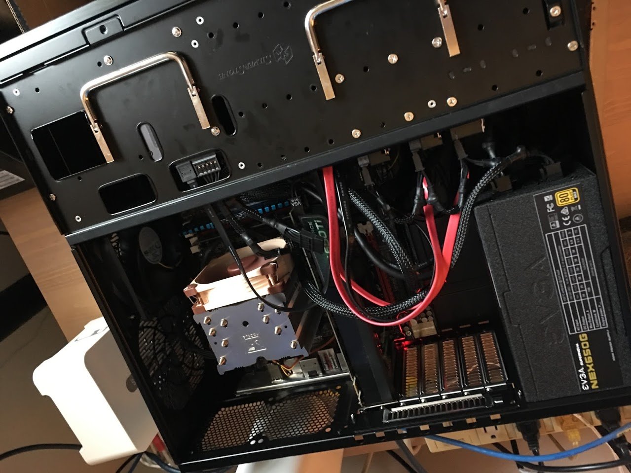

What you purchased  seems considerably less expensive than my solution but here is my setup that may have worked. This runs in my bedroom and had to be quiet.
My Unraid server is built in a Silverstone Grandia GD08. I do not have it in a rack but you can purchase rack mounts for this case. I have a full size GTX 1060 GPU with a Micro ATX M/B but it  can accept ATX. Comes with 2 underside fans. I think. I have 4 x 3.5 inch, 1 x SSD, 1 x NVME. Will easily fit at least 3 more 3.5 inch drives. It has a removable caddy so you can place drives in first and then place them back in the case. The cable management is average and will be spaghetti. It also has two DVD bays which could be used for 3.5 inch drive placement as well. It runs pretty quiet with the included fans. I have a Noctua CPU cooler and an additional rear Noctua fan which keeps the server cool enough and quiet.
The rack mounts look questionable whether they can hold all that weight on their ears.. I would suspect you would need back support if you put it in a rack. 144 USD as of 6/12/2018 on US Amazon.
This PC case looks like a Stereo receiver so it blends well in a cabinet.
Attached an overhead photo of case. The Two flat handles are seen that are used to lift caddy out of case.

Wow that thing looks diddy for what i has inside!
I'll take some pics of mine later, but mine is super spacious compared :)
