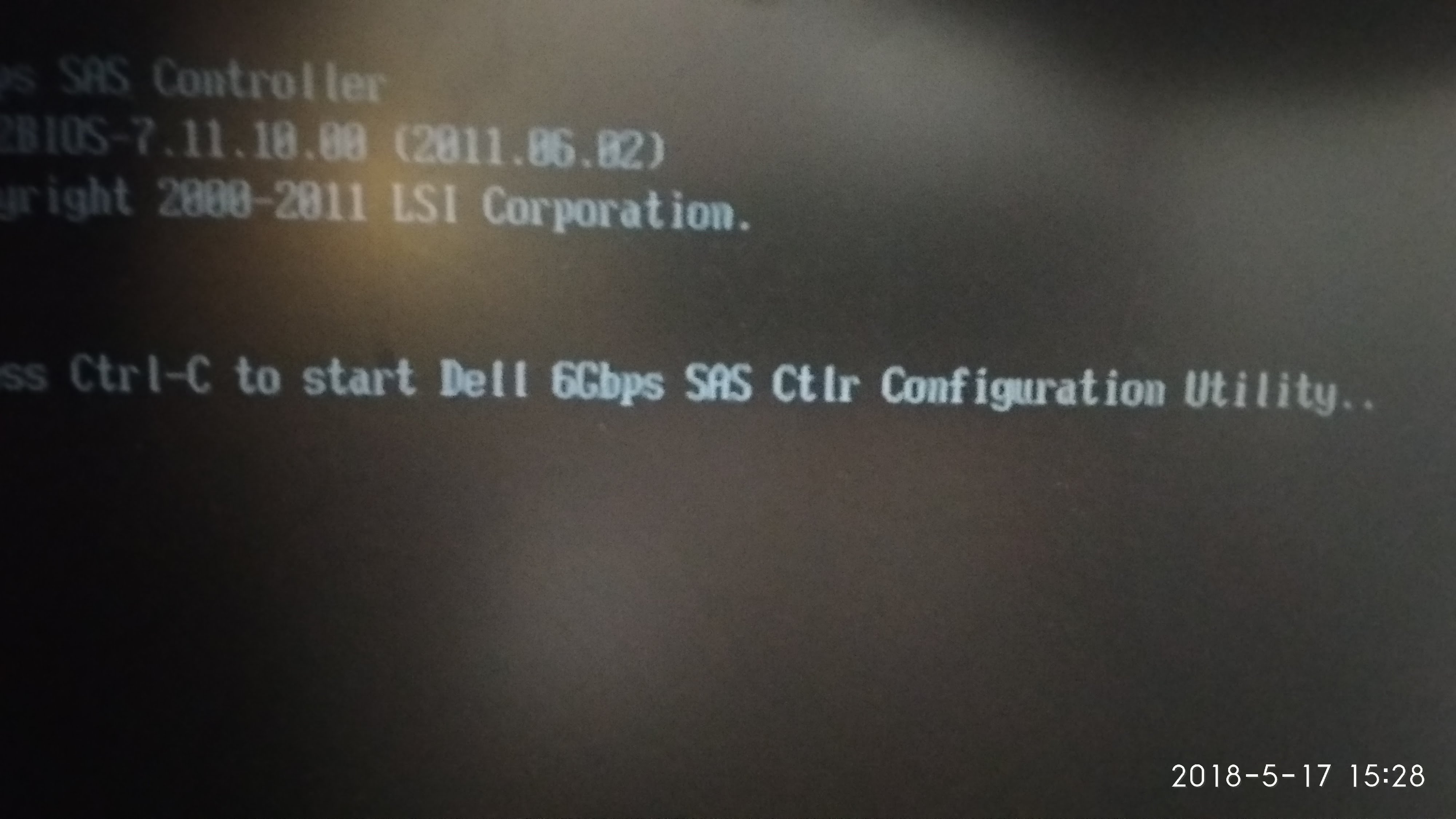

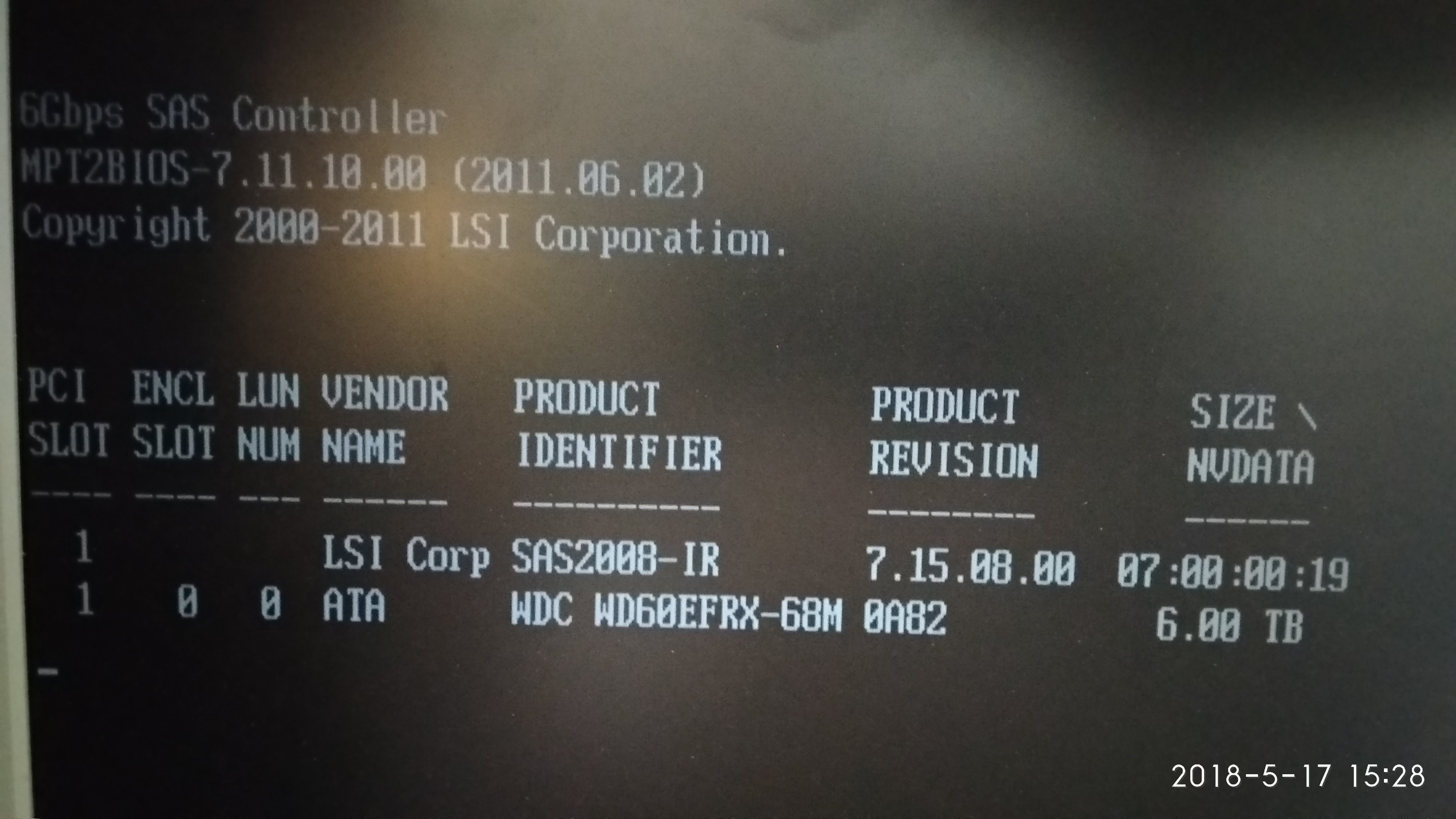

So, I just got an H200 controller. I already have one that did not work until I crossflashed it to P20, but this new one works although I think it is not flashed. It is not clear to me what its state is by the post results:
Obviously it has a BIOS (my crossflashed H200 is without a BIOS),  the vendor name is LSI but DELL is mentioned in the first screen I posted and the firmware is 7.15.08.00.
Should I crossflash following the instructions for Dell H200 from here?
Edited by papnikol
solved
Just in case someone stumbles on this post, I successfully crossflashed the card
