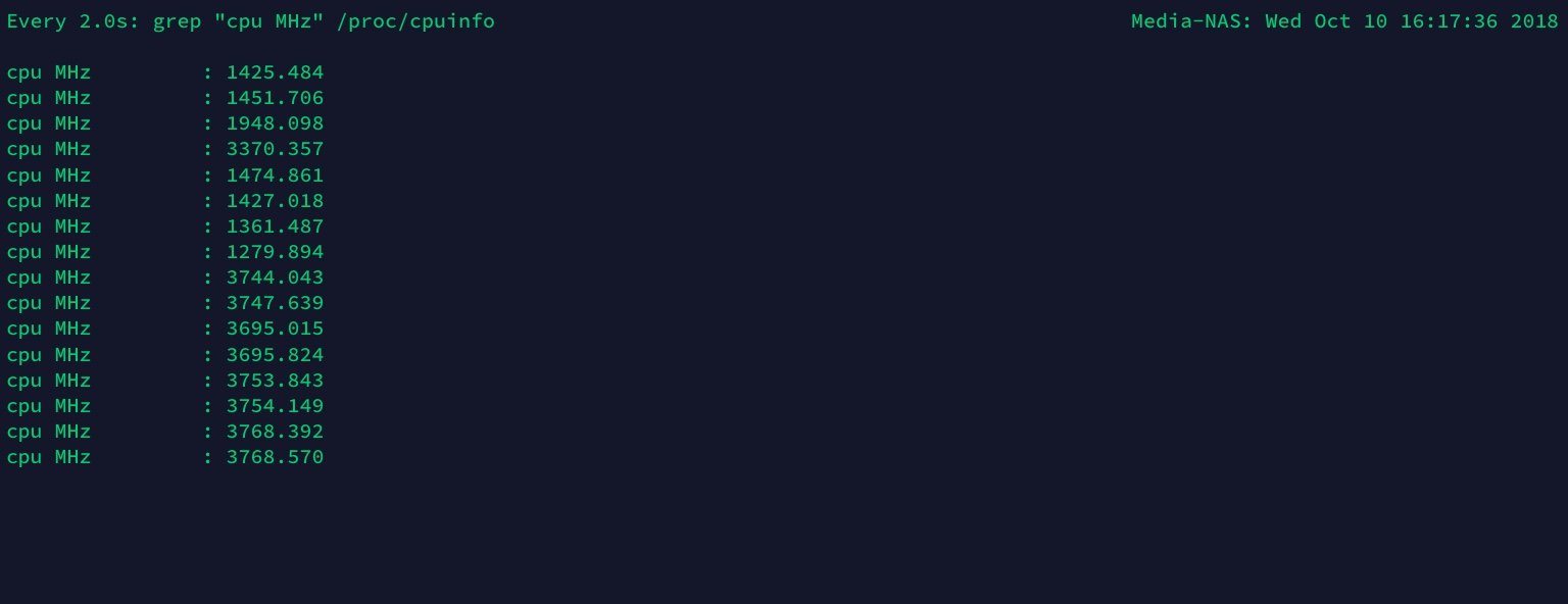

My Ryzen 2700 now clocks up to 4.2 GHz easily.I’m not sure if that is XFR or Precision Boost.
UnRaid 6.6.1 on a x470 Taichi with stock BIOS setting.

@tjb_altf4 Clocks back to 1.2 GHz when idle.In the picture core 8-16 cores are pinned to Plex and under load while others are idle.
