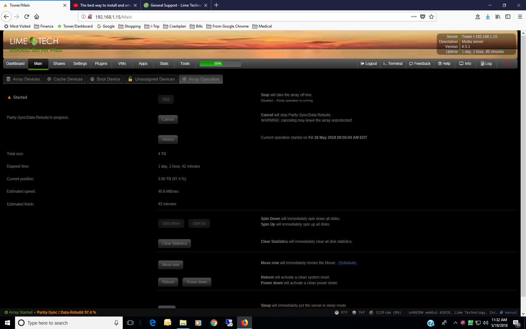

Additional Info: Screen shot of parity rebuild showing elapsed time
