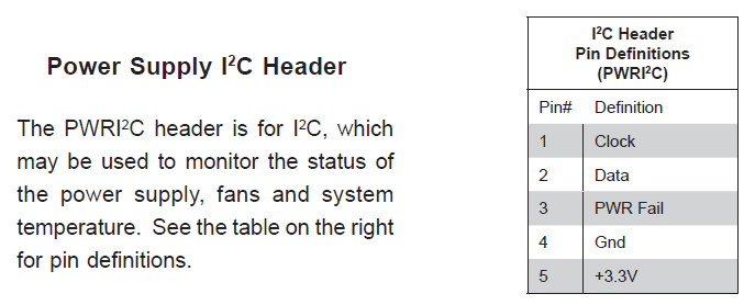

Sadly no joy with the normal PS, wouldn't even boot. However, I did discover something else, but I have nothing to reference to.
So, if anyone has an H8DME-2 out there, and ready access to it, there is a (black ?) 5-pin header immediately adjacent to the the white ATX/CPU headers.
Does anyone only have 4 wires going to that black 5-pin header? The manual calls for five, but mine only has four and the missing one is a 3.3V lead.
Maybe I just need a new PS docking unit?
Fingers crossed for a reply!
Edited by TechMed
Cut from manual
