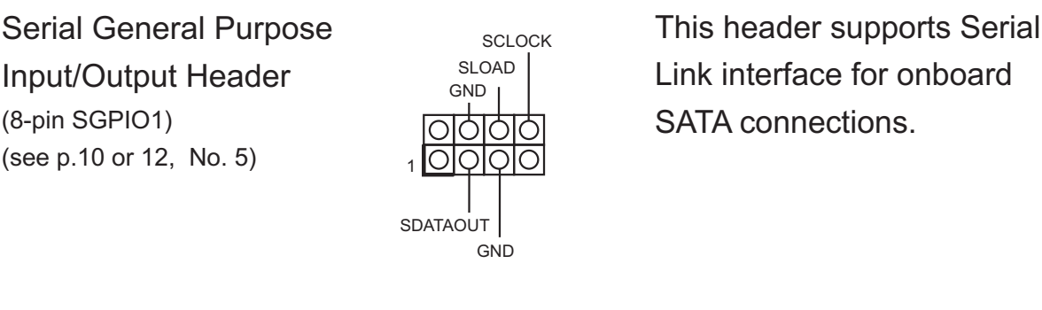

after successfully installing an H310 and flashing it to IT mode, I was wondering if it possible to connect the LED cable of the H310 to the SGPIO header of my Asrockrack E3C226D2I to have the HDD led of the case indicate drive activity. The header of the board follows the normal layout:
If so, how would I connect the 2 pins? I am not sure what to make of all the google searches that I did, which is why it would be great if anyone has an idea. ?
Thanks!
Those header was connect to backplane, not for controller interconnect. And different controller may have different protocol even all simple name SGPIO.
