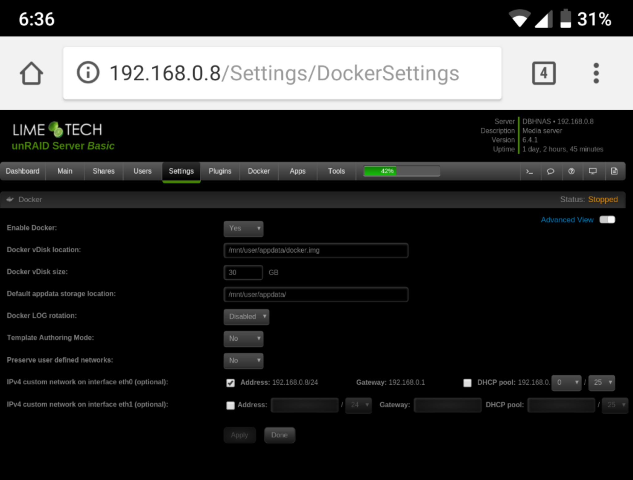

Hey there. I think I'm having a similar issue. How do you delete your docker image? Should I do this via putty and midnight commander or is there something you can do in web gui?
Diagnostica attached.
dbhnas-diagnostics-20180528-0821.zip
In the GUI go to Settings -> Docker
First stop the docker service and you are able to delete and create a new image.

Sorry for the dumb question but where??
Apparently the docker service failed to start (status = stopped)
Change "Enable Docker" to "No" and click Apply.
