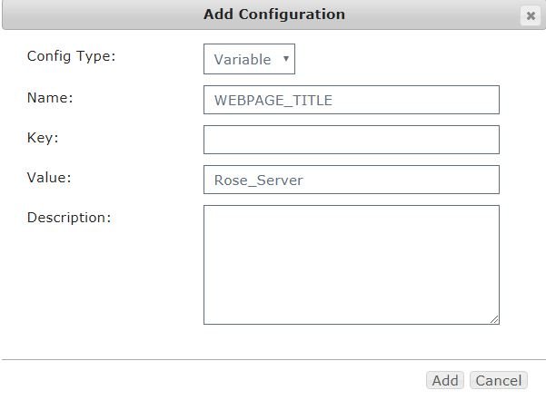

1. you can now define the name shown in your browser tab for novnc, you can define this by adding in an env var with name 'WEBPAGE_TITLE" and the value being the string you want shown, if no value given it will default to the containers hostname.
This is what I did:
I can't find the server name.  What am i doing wrong?
Edited by Frank1940
27 minutes ago, Frank1940 said:
This is what I did:
sorry my bad, i meant KEY not 'name' so move WEBPAGE_TITLE to the Key: field
That worked!  Thanks for all your efforts

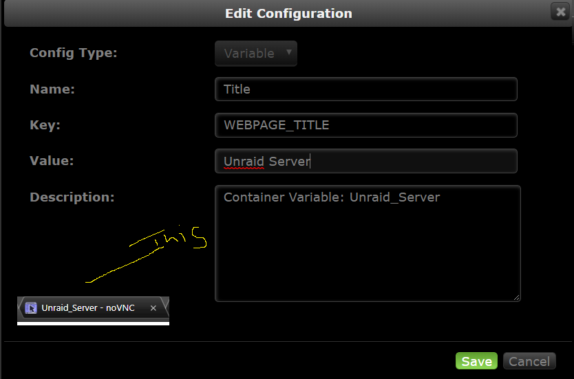

Loving this, thanks Binhex.
I changed title, nice touch.
