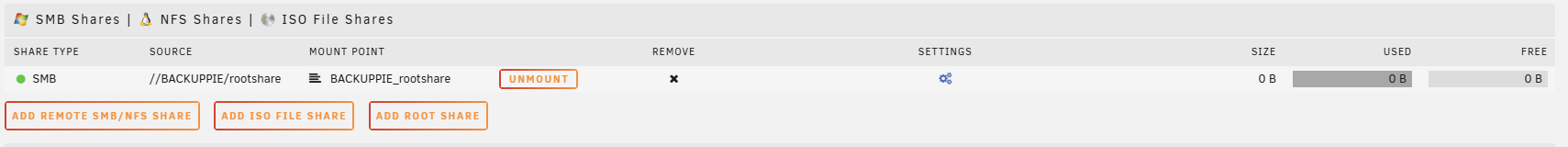

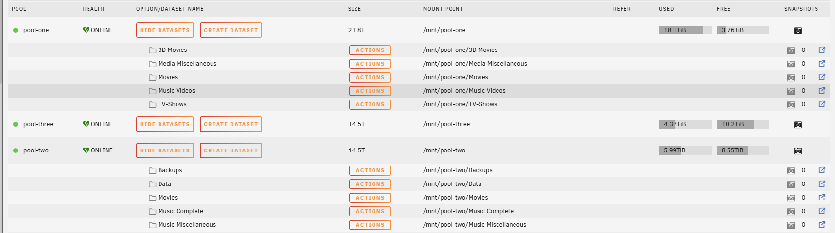

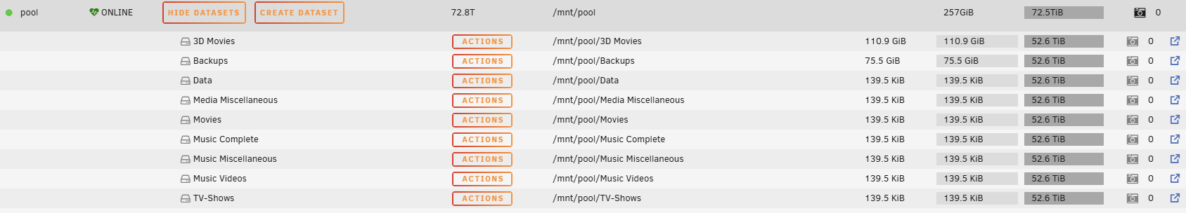

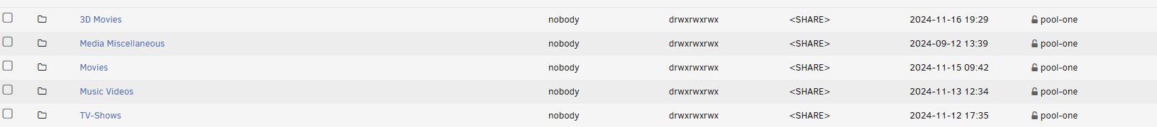

If I mount a root share, with <my name> via Unassigned devices from my Mainserver to my Backupserver, or even the other way around, and using Krusader, even after restarting that docker, both Krusaders (the Mainserver or the Backupserver one) say that there is not enough disk space. The drives were empty!
I did not have this issue before, but for a while, I cannot use Krusader anymore to copy to the other server.
MC does work so what is different from MC vs Krusader?
Could it be that Krusader is not able to work with datasets?
I have tried with a root share, <my name> and on both servers the same password for that account.
I have tried to mount the shares separately, also no success.
What could be the reason for this behavior?
MAINSERVER:

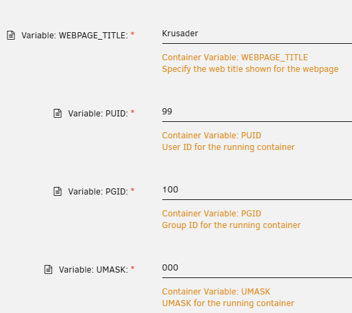

Krusader config:

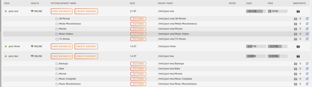

Pool config with zfs dataset and space available
Share mount to 'Backupserver'
BACKUPERSERVER config:

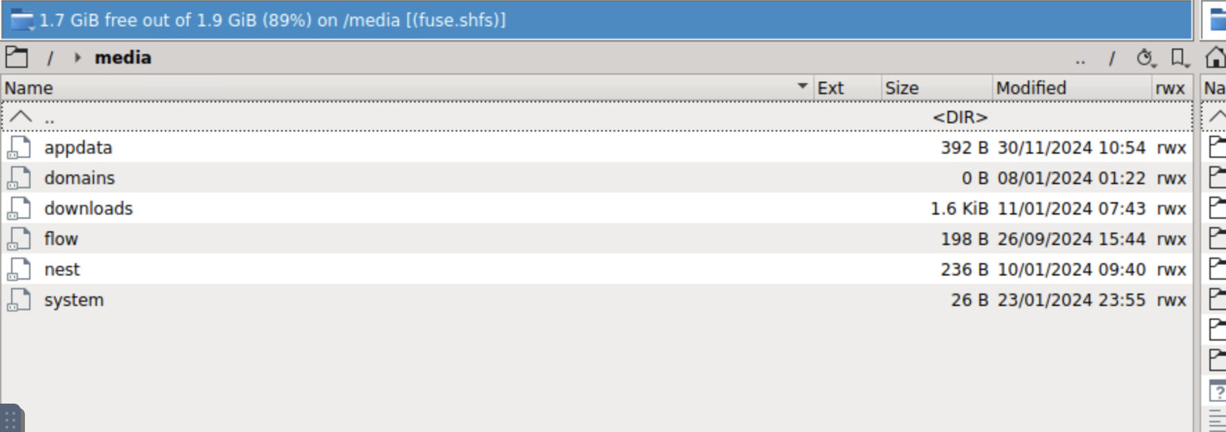

I installed binhex-krusader. If I navigate to /media I can see my shares, however, I cannot look inside the folers, instead it asks me which application I want to use to open them:
That is because for some weird reason those are not folders they are files, what is the host path set to for /media for the container?
My host path is `/mnt/user`
I am using default settings for everything.
I believe this might be an access rights issue, somehow.
Edited by neuronflow

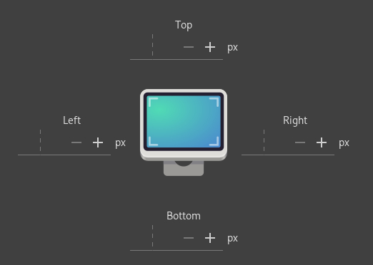

After the update I'm having a bizarre issue where the window doesn't auto-resize anymore and it's above the VLC window so you can't move it down or manage the tabs. Anyone else?
(edit)
As a work-around, I was able to at least modify the openbox config in the internal terminal by editing ~/.config/openbox/rc.xml and adding the following couple of lines:

Then you can use Alt+Down to move the window down to at least grab the top bar. Even once you move it down if you try and maximize it, the window is stuck in a very odd position 2/3 of the way down the screen. So weird, but at least I can half-way manage the window now. Still have no idea why it exhibits this behavior.
(edit 2)
Apparently the margin for the window has a value set but it's completely invisible so I wasn't able to see it having a value and it looked completely blank. Double weird. See for yourself:
However, if you click into the field and just hit backspace and delete to ensure you remove the value, it fixed the issue. Still doesn't explain how it got set this way after the update. I definitely didn't set this value before.
Edited by Dub
i see the exact same thing so its not just your config, trying to work out what config file to modify to fix the issue then i can include it in the image, thanks for your detailed post so far, its appreciated.
how did you get to this window?
edit - figured it out.
Well that was super frustrating but i found a way of moving the window around:-
press and hold ALT then use left mouse button and you can then drag the window around and resize it correctly, once in the correct location and size then exit krusader (right click icon in taskbar) and then launch it again (right click desktop/krusader) and it should then be set correctly.

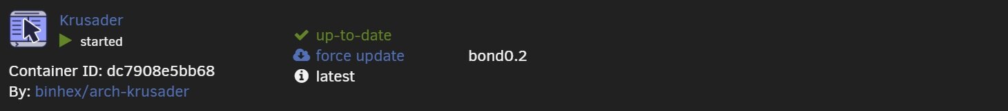

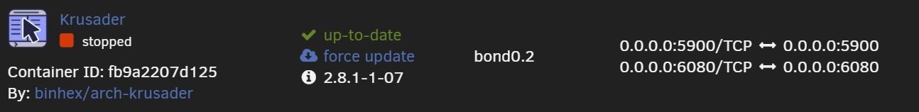

Updated my container this morning to the latest version (2.9.0-1-01) clicked on the webgui link and got a blank page.  I then noticed on the docker page the container never gets assigned an IP address, the IP addresses are blank.  The container was up and running, using the console I can see all the directories but no way to access the GUI.  I manually set my IP for the container if that makes a difference.  I rolled back to 2.8.1-1-07 and everything works like before.
2.9.0-1-01
2.8.1-1-07
Minor request, please update the support link.  Looks like it is pointing to: "https://unraid.net/forums/topic/71764-support-binhex-krusader/" and needs to point to: "https://forums.unraid.net/topic/71764-support-binhex-krusader/".  Thanks!
this is an unraid bug which apparently is fixed in v7.xx:-
bokmark the url instead in your browser or upgrade to v7.xx beta/rc.
