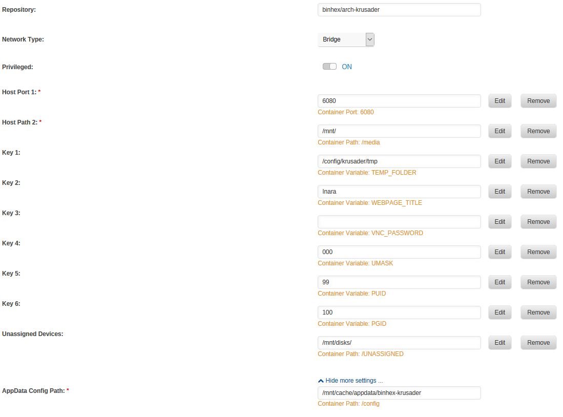

On 6/10/2018 at 9:45 PM, Griz said:
When I start up Krusader after installing, I get a dialog box saying something to the effect of "Unable to write to /home/nobody.....  bookmarks won't work until you fix this".
What do I need to configure?
@Griz Change your AppData Config Path to: /mnt/user/Docker/binhex-krusader
I had the same problem and this fixed it.
Thanks!   I just changed it from the cache drive to the user share like you and that fixed it.   /mnt/user/appdata/binhex-krusader

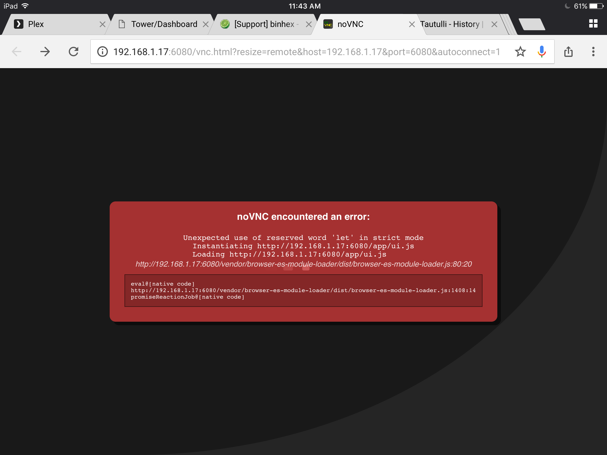

Just switched over to your docker from sparky's and when I load up the web interface I am greeted with this. Any ideas?
possibly related to the browser you are using, i see that screenshot is taken from an ipad and thus i guess browser is safari (or mobile version there of), can you try viewing it using chrome on mac or pc?.
Sorry, forgot to post back here after trying on the PC. It did work on my PC but also the chrome browser on my phone as well as th chrome browser on my other iPad. It seems to just be this iPad where I get the error. It isn't that big of a deal but any idea why that might be happening? It's weird how it works on my other iPad but not this one.
maybe your other ipad is a older model and there are some driver/graphics issues that manifest themselves for certain websites (i.e. novnc), unsure really. if you feel like you really want to get this fixed then please create a github 'issue' for it on the novnc github repo https://github.com/novnc/noVNC/issues

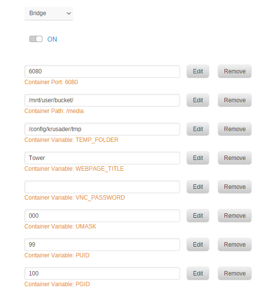

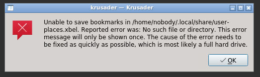

Hi.  After initially starting Krusader, I was shown the following:
image.png.016464d7d60eb079bb2ce7b0bf1c1a33.png  What's wrong with my setup?
This is in my config page:
I am having *exactly* the same issue as jang430 (above ^) and would also love to know how to fix this and use Bokkmarks successfully.
And thank you so much for this update to the excellent Krusader, which I have come to rely on for almost everything related to file-maintenance on my trusty old unRAID system.
THANK YOU! (beers are a'coming)
please attach the log file /config/supervisord.log here.

yes you can safely delete it if its not being being referenced by the new container.
your issue is related to permissions, snippet from your log:-
2018-07-23 19:09:11,968 DEBG 'start' stderr output:
cp:
cannot create directory '/config/krusader/.config'
: Permission denied
so it looks like user 'nobody' (defined by PUID 99) and group 'users' (defined via PGID 100) do not have permissions to write to whatever host path /config is defined as. you can fix this by simply stopping the container and then run the following command, replacing the bit in <> with your host path to whatever /config is mounting:-
chown -R nobody:users <host path to /config>
chmod 755 -R <host path to /config>
then start the container again.
do NOT chown/chmod your entire cache drive, this can/will cause issues with other containers, just the krusader config folder only.
