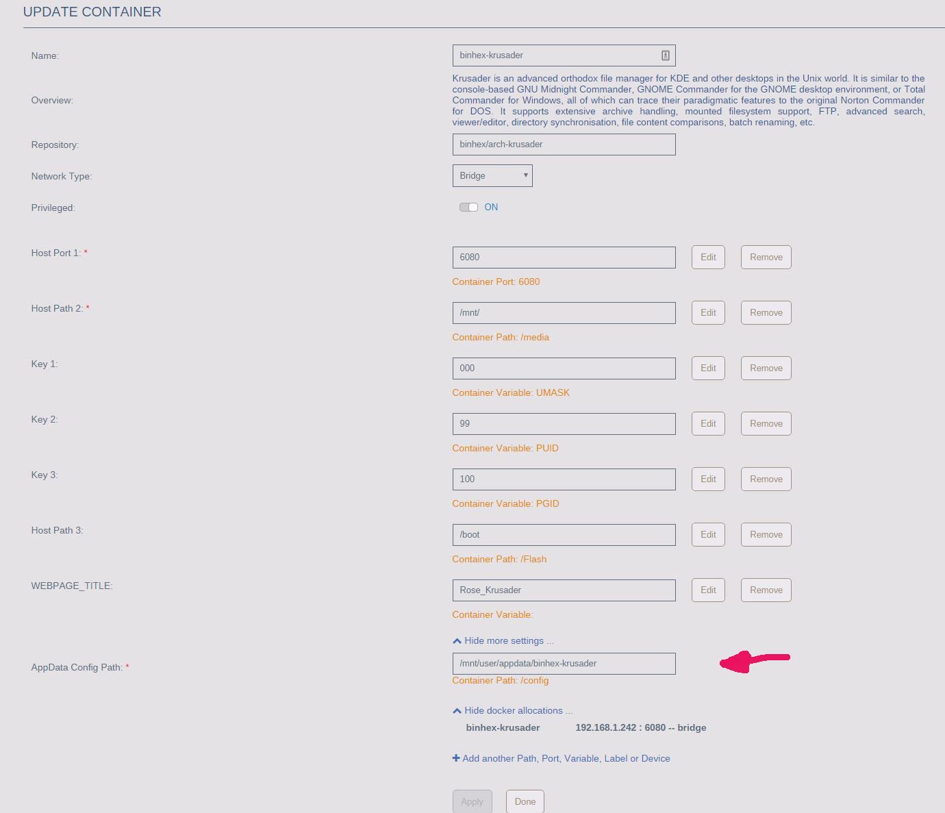

This is what My settings look like.  Notice the AppData Config Path variable ---- Do you have this?
the krusader folder that I have is inside appdata, not inside binhex-krusader.
My settings look like this:

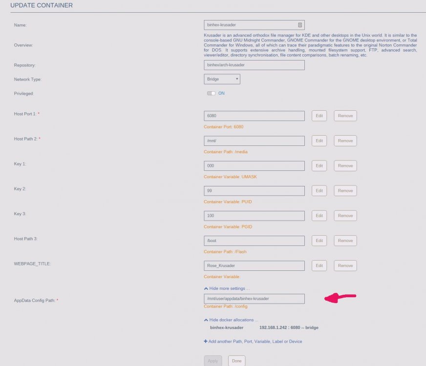

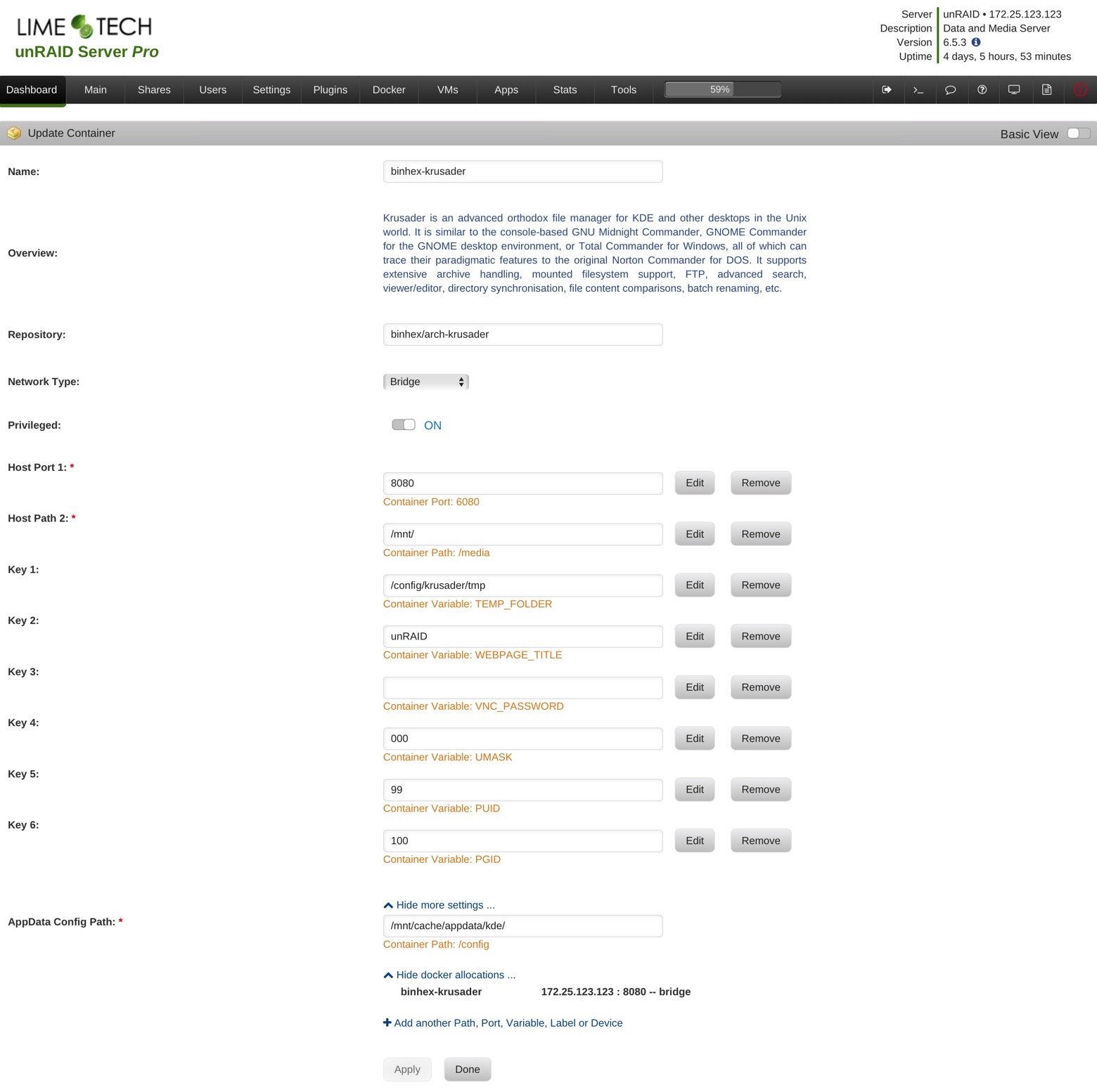

looking at your screenshot you should be running chmod and chown against /mnt/cache/appdata/kde im assuming each application has its own config folder right?,  thats how it should be.

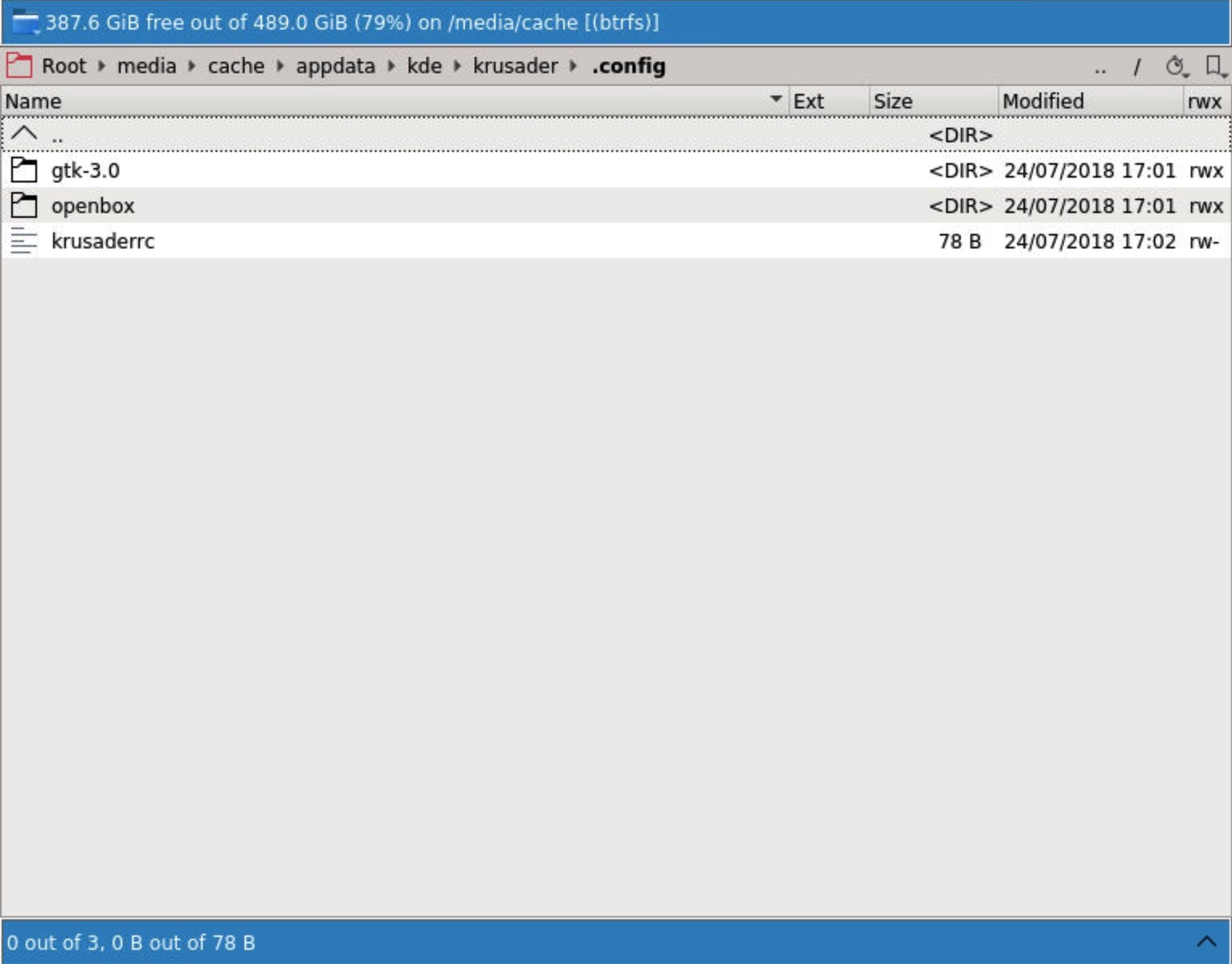

ok so that log file looks cleaner now, no signs of any permissions issues, if you now look in the following location do you see files/folders? :-
/mnt/cache/appdata/kde/krusader/.config/
if so then it is now correctly writing settings out, make a small change to something in krusader and then restart the container, you should now NOT receive the message telling its first run and the change you made should be persistent.

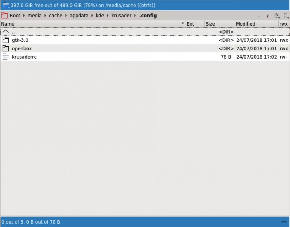

this is what I see
then let me try out what you suggested
the settings changes I made (colors) made it through a restart of the container, but I still get the warning that bookmarks cannot be saved ?
