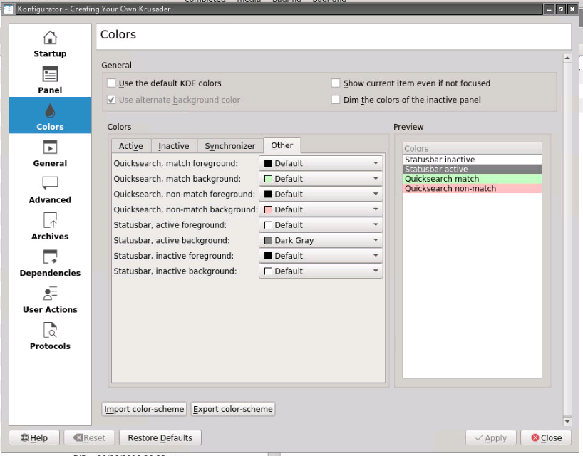

On 7/25/2018 at 5:19 PM, tillkrueger said:
I was trying to find the parameter responsible for those but couldn’t find it...do you know that is accessible via the settings UI?
see screenshot below, untick option "Use the default KDE colors", then change parameter "Statusbar, active background" to the colour you want, works for me :-).

Say what?
Right again, binhex! I didn't look at the "Other" tab before, but found it to do exactly what I need. So cool, this Docker!!

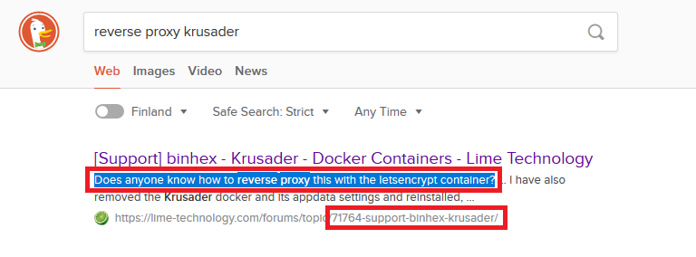

I know I asked somewhere how to reverse proxy this with the letsencrypt container. Was my post deleted? I cannot find it any more. It shows up in Google that I asked, but my post is literally nowhere in this thread.
I'd still like to know how to reverse proxy this docker app. If anyone has a proxy .conf file or something I'd honestly appreciate it and if my post was deleted I would like to know why because it's a legitimate question.
Edited by plantsandbinary
How about HERE:
No I asked specifically HERE in this thread about reverse proxying this particular container with letsencrypt. I don't have memory problems, someone deleted my post. It's still indexed in various search engines but the link just redirects to the first page in this thread.
I shouldn't have to spell this out. There is literally no reason why my post should have been deleted.
If someone has a working reverse proxy config for this, please share it.
